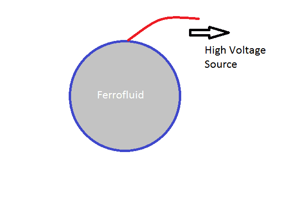

What will happen in a ferrofluid in an elastic cylindrical tank when subjected to high voltage alternating current? Is it will expand and then back to its normal dimension periodically because of repulsion?
The diagram on the attachment is the set-up, all answer will be appreciated. Thanks

Hi etherist. Welcome to Physics Forums!
You have proposed subjecting the ferrofluid to a "high voltage alternating current". Looking at your thumbnail I can see only one wire that leads to a "High voltage source". As we know, no current can flow without a complete circuit. Members here are ready and willing to offer you useful responses, but need some more information. Please give some more details.
1. Where is the "return" wire attached?
2. Do the wire(s) enter the elastic tank and make contact with the ferrofluid?
Bobbywhy
The ferrofluid is electrically connected to the top wire of a tesla coil. Is it will operate without return since i will use tesla coil? I want to test an experiment but i do not have tesla coil, and this set up of experiment is not available on youtube. Is there any vibration that will happen in the elastic tank? Thanks a lot.
The application of a static voltage would not cause any reaction by the ferrofluid.
Notice there could not be any current flow.
Even if a "return" wire was connected to the ferrofluid there would not be any reaction.
Ferrofluids are a non-conductors.
If you want the sphere to "vibrate", or move with an applied signal, you must use a magnetic field.
