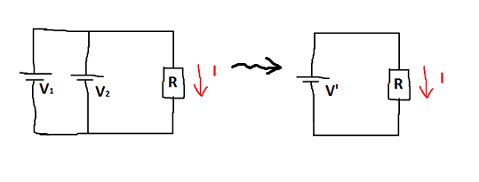

I have a question about natural limitations when the superposition principle for circuits is applicable. Possibly there is a quite elementary reason why the problem I'm going to present next fails, but up to now I haven't a precise reason why that's exactly the case. Could somebody help?
Consider the following situation which rather confuses me:
The voltage sources ##S_1## and ##S_2## with voltages ##V_1## and ##V_2## which we assume to be equal: ##V_1= V_2 (=V)##
We want to calculate the current ##I## across the resistor ##R## using two methods: 1) usual standard way we learn to add up two parallel voltages and 2) aplication of superposition prinicple.For 1): Due to basic calucation rules for two parallel voltage sources with SAME voltage ##V_1= V_2 ## we can make a replacement:

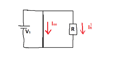

For 2): On the other hand if we try to apply the superposition principle to this circuit and short out say ##S_2## then we
obtain
with ##I_{\infty}= \infty ## and ##I^1_R=0## since we have shorted ##S_2##. From symmetrical
reasons in the same game shorting out ##S_1## we obtain ##I^2_R=0## and therefore ##I= I^1_R + I^2_R =0## and that
contradicts to the considerations above.

The second method is not allowed, because if an ideal voltage source with zero internal resistance is connected to a zero-resistance circuit, the final voltage or current cannot be determined. Since the result of multiplying zero by infinity is in an indeterminate form, this contradicts the constant voltage of an ideal voltage source.
In the first case, the resistor obeys Ohms law. I = V / R.
Half the current comes from each battery.
In practice, the two voltages are not exactly the same. There will be a high current (slight voltage difference divided by zero ohms) going from one battery to another.

Any network that contains a loop of only voltage sources and/or capacitors is not solvable, not realistic. The same is true of any circuit node that has only current sources and/or inductors connected to it.
So, while you will get a bunch of answers from people, this is, by definition, not a solvable circuit. I suppose there is the trivial case where the sources are equal*, in which case, why not just delete one?

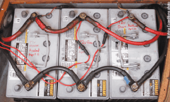

The standard way to create a house battery bank.

Ok, so in summary the point is just that the superposition principle always subliminally assumes that we work with solvable circuits in the sense that there is nowhere loop with short circuit in the given circuit.
Your network needs some rules about what the voltage is across each branch. You just can't have rules that conflict. Rules that agree and provide identical information (the trivial case) are redundant and one can be immediately eliminated at no cost.
The algebraic equivalent is this:
x=2 and x=3, find the value of x.
Or, x=2 and x=2, find the value of x.
It's not rocket science, don't dwell on the obvious, it's not worth your time.

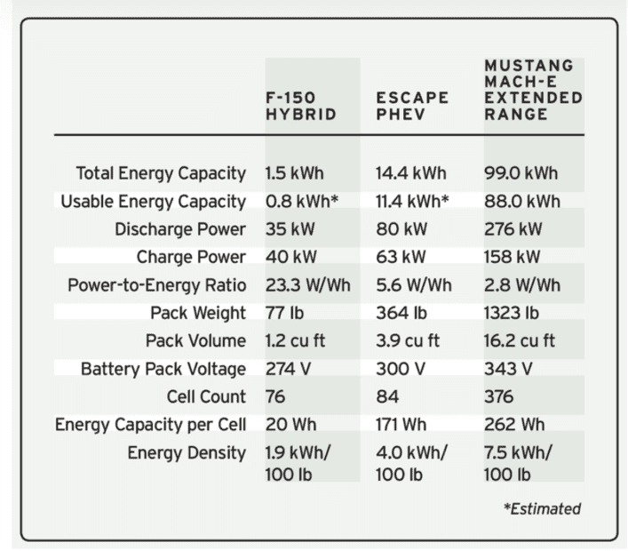

Don't forget EV battery packs. They necessarily have series and parallel connections.
Wouldn't all the batteries be same batch, same age, same use? Also, in an expensive setup like an EV, wouldn't there be a lot of monitoring to spot potential problems?

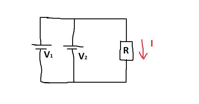

Consider the following situation which rather confuses me:View attachment 294570
Now if we set ##I_1## to be the current in
View attachment 294572then ## I= 2I_1##.
obtain
View attachment 294573with ##I_{\infty}= \infty ## and ##I^1_R=0## since we have shorted ##S_2##. From symmetrical
So seemingly in this situation the superposition principle fails because 2) make no sense at experience level. But on the other hand I read that the only obstruction to use superposition principle is the requirement that the circuit/network should be linear, that's all as far I know.
This one is linear. But seemingly the application of superposition here gives absurd results.
Where is the error in my reasonings?
You cannot short one source (V1=0) while the other is at V2 = V'. You have contradicted yourself.
