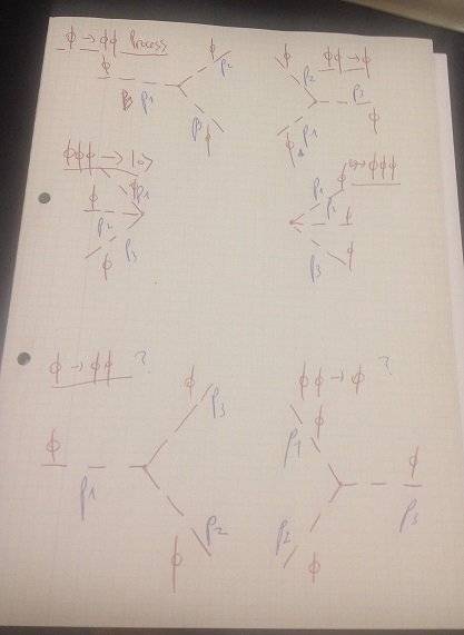

I've been thinking about this but I do not fully see the 3!=6 possible diagrams. The Feynman diagrams I get are
The first four are OK but what about the last two?
But how can we be sure that there are 3! possible diagrams, before actually check it out explicitly? Is Wick's theorem a way to check that out?
Nop. you are drawing diagrams for different processes, that's not what I'm talking about, if you want to take the first option there are 6 diagrams to draw for the ##\phi \to 2\phi## process. You have 3 external lines (representing the 3 particles at infinity) and 3 legs of the vertex to connect. Therefore 6 possibilities (3 for the first pair, 2 for the second, and the last one is immediately determined).

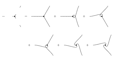

OK I get we have 3 external lines but what do you mean by 'legs of the vertex' ?
Let's see if I can light your way, in the picture, I draw a first diagram, where you can see the three external lines (the outer ones) and the three legs of the vertex (the three lines touching the point). What you need is to pair these lines (one external with one leg of the vertex), there are six ways to do it, which I have drawn after the ##=## sign.
Note I am using the orientation of the external and internal lines as a way to distinguish them, but in reality, we can adjust these directions to make the six diagrams look exactly the same as the first one.
  • Wow
Sorry but I am afraid I got lost.
what kind of rules are you following to draw the internal lines? I do not understand why you are allowed to curve them (I was only thinking in terms of straight lines)
I'm just connecting the external lines with the legs of the vertex with lines, as always in Feynman diagrams, curved lines or straight lines make no difference, is just a way to make them look nicer. If I write only straight lines then all the pictures look the same and there's no way to see why there are 6 and only 6.
There's no secret, just draw on a paper the external lines and the legs of the vertex (i.e. draw on a paper the picture on the left of the ##=##) and then connect them by lines...
In any case, if you are not used to this kind of pictures, is better to forget about the 3!, and take
$$\lambda = -i\lambda_3$$as your Feynman rule (which is what everyone does), and then you will need to draw only one diagram.
Although I must say that this kind of pictures are really useful to determine symmetry factors.

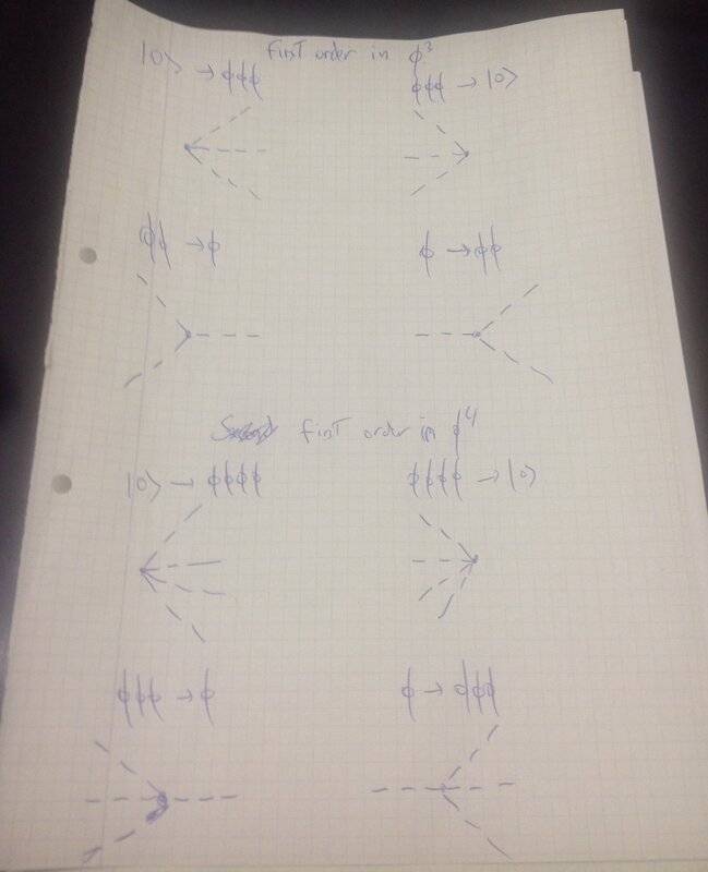

Just to check my basic understanding of Feynman diagrams; these are the basic (i.e. only first order) processes of our theory (in a very schematic way)
