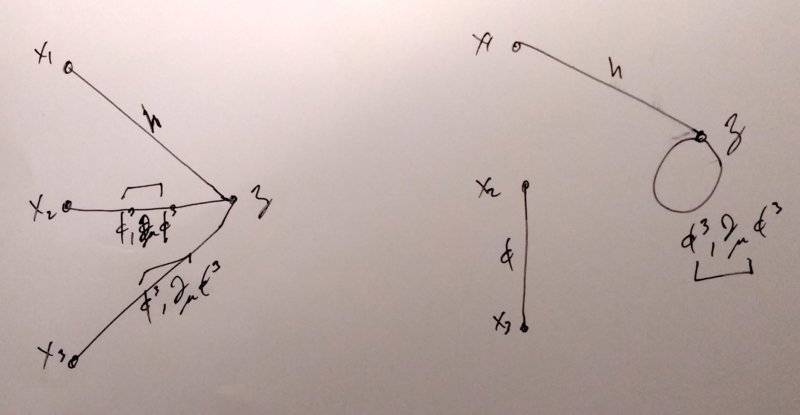

Given a coupling [itex]h \; \partial_\mu \phi^a \partial^\mu \phi^a[/itex], meant to model the first order interaction of the Higgs field [itex]h[/itex] to boson fields [itex]\phi^a[/itex], compute the width [itex]\Gamma(h \rightarrow \phi^3 \phi^3)[/itex] of the Higgs particle to decay to two longitudinal (say) [itex]Z[/itex]-bosons (hence the index [itex]3[/itex]).
We've been told that we only need to consider first order perturbative terms.

Based on the scalar theory example [itex]\phi \phi \rightarrow \phi \phi[/itex] example we worked in class, I figured that I need to calculate the first order diagrams of
[tex]\begin{aligned}{\left\langle {0} \right\rvert} &T( h(x_1) \phi^3(x_2) \phi^3(x_3) e^{-i \int d^4 z H_{\text{int}}(z) }) {\left\lvert {0} \right\rangle} \\ &={\left\langle {0} \right\rvert} T( h(x) \phi^3(y) \phi^3(w) ( 1 - i \int d^4 z h(z) \left( { \partial_0 \phi^3(z) \partial_0 \phi^3 z + \partial_k \phi^3(z) \partial_k \phi^3(z) } \right) ){\left\lvert {0} \right\rangle},\end{aligned}[/tex]
Because [itex]h, \phi^a[/itex] commute, as well as any [itex]\phi^a, \phi^b, a \ne b[/itex], it seems to me that the contraction of [itex]h(x), h(z)[/itex] results in a Feynman propagator
[tex]\begin{align}D_F(x - z)={\left\langle {0} \right\rvert} T( h(x) h(z)) {\left\lvert {0} \right\rangle}.\end{align}[/tex]
We can also have contractions between [itex]\phi^3(y) \phi^3(w)[/itex] and the derivatives of the [itex]\phi(z)[/itex]'s in the interaction integral, or contractions between the [itex]\phi^3(y), \phi^3(w)[/itex]'s and the derivative terms, but all the [itex]h, \phi^a[/itex] contractions should be zero since those fields commute. I thought the interpretation of the contractions of the derivatives fields would be
[tex]\begin{aligned}{\left\langle {0} \right\rvert} T( \phi^3(x_i) \partial_\mu \phi^a(z)) {\left\lvert {0} \right\rangle}&={\left\langle {0} \right\rvert} T( \phi^3(x_i) \partial_\mu \phi^a(z)) {\left\lvert {0} \right\rangle} \\ &={\left\langle {0} \right\rvert} T( \phi^3(x_i) \partial_\mu \phi^3(z)) {\left\lvert {0} \right\rangle} \\ &=\partial_\mu^{(z)} D_F( x_i - z ),\end{aligned}[/tex]
the derivative of a Feynman propagator for [itex]\phi^3[/itex] between the [itex]x_i[/itex] and [itex]z[/itex] vertices.
It seems to me that there's only two diagrams (sketch attached), but the derivatives in the interaction are still bothering me, and I suspect that I've messed up the starting point for this problem significantly.
  • Handwritten Feynman diagrams: left, a vertex joining external lines x1, x2 and x3 to an internal line labelled h, with a bracketed factor below; right, a line from x1 to a loop at the vertex labelled h, and a separate line from x2 to x3 labelled phi, with a bracketed factor below.
Any insight or guidance would be greatly appreciated.A:You are correct in your approach so far. The only thing to note is that the contraction of the derivatives in the interaction Hamiltonian should be done with the usual propagator for scalar fields, i.e.\begin{align*} \langle 0|T(\phi(x_1) \partial_\mu \phi(z))|0\rangle = \partial_\mu^z \Delta (x_1-z)\end{align*}where $\Delta (x_1-z)$ is the scalar propagator.The two diagrams you mention are the only ones that contribute at leading order. The only thing left to do is calculate their value and take the imaginary part.
