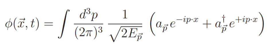

The issue I have in here is that when evaluating each term individually I do not get the factor of ##1/3!## canceled out. Let's show one computation explicitly
\begin{align*}
i \frac{\lambda_3}{3!}\int d^4 x \langle f| \phi^- \phi^- \phi^- (x) |i \rangle &= i \frac{\lambda_3}{3!}\left(\frac{1}{2V \omega_{\vec k}}\right)^{3/2}\langle f| b^{\dagger}(\vec k)b^{\dagger}(\vec k)b^{\dagger}(\vec k) |i\rangle \int d^4 x \exp\left(3k\cdot x\right) \\
&= i \frac{\lambda_3}{3!}\left(\frac{1}{2V \omega_{\vec k}}\right)^{3/2}\langle 0| b(\vec k)b(\vec k)b(\vec k) b^{\dagger}(\vec k)b^{\dagger}(\vec k)b^{\dagger}(\vec k)|0\rangle \int d^4 x \exp\left(3k\cdot x\right) \\
&= i \frac{\lambda_3}{3!}\left(\frac{1}{2V \omega_{\vec k}}\right)^{3/2}\langle 0|0\rangle \int d^4 x \exp\left(3k\cdot x\right) \\
&= i \frac{\lambda_3}{3!}\left(\frac{1}{2V \omega_{\vec k}}\right)^{3/2} \frac{1}{3}\delta^{(4)}(k)
\end{align*}
Where I've used (I am indeed working in n.u.)
\phi^-(x)=\sum_{\vec k} \Big(\frac{1}{2V \omega_{\vec k}} \Big)^{1/2} b^{\dagger}(\vec k)e^{ik \cdot x}
\big[ b (\vec k) , b^{\dagger} (\vec k') \big]=\delta_{\vec k \vec k'}
\int \mathrm{d}^4 x \exp(\mathrm{i} ({k}_1-{k}_2) \cdot {x})=(2 \pi)^4 \delta^{(4)}({k}_1-{k}_2).
\langle 0|0\rangle=1
As shown, I get no ##3!## factor canceling ##1/3!## out... What am I missing? I think once I see my mistake, b) will be easier to establish

I don't agree with that, could you please expand ##\phi^{\pm}(x)## in terms of creation and anihilation operators?

$$\phi(x) = \phi^+ (x) + \phi^- (x) =
\sum_{\vec k} \Big(\frac{1}{2V \omega_{\vec p}} \Big)^{1/2} \left(a(\vec p)e^{-ip\cdot x}+b^{\dagger}(\vec p)e^{ip\cdot x}\right)$$I follow Mandl & Shaw (page 44)
JD_PM said:
Oops my bad! I was only dealing with the creation and destruction of one type of particle. Instead, I should be dealing with two types. The following may look better
I've been thinking a bit about this. If we assume two types of particles then we would need another expansion, involving ##\phi^{\dagger}##.
I think we should only working with the destruction/creation of only one type of particle. I believe you wanted to use the following expansion though
Well, as you say, we should only work with one type of particle, because using the condition ##\mathscr{L}=\mathscr{L}^\dagger## we obtain that ##\phi = \phi^\dagger##, so ##a(\vec{p})=b(\vec{p})##
And yes, I'm more comfortable using the continuous expansion of ##\phi##, but if you are supposed to do it with the discrete case, let's do it. In any case, continuum or discrete, can you give an expression for
