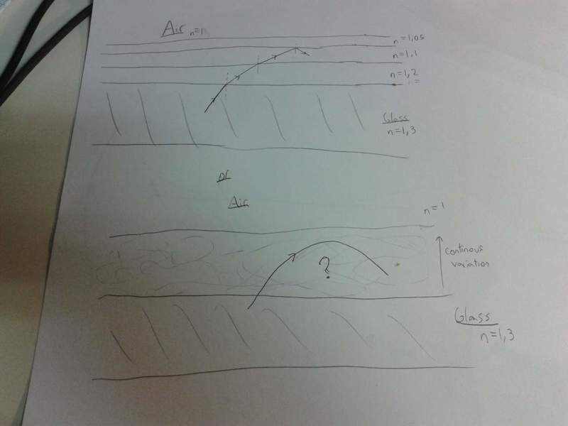

My teacher said that instead of using a fiber optic made of just one material we could use a set of materials with progressively low refractive index to turn the light back in, like so:
Hand-drawn diagram in two parts: top shows a light ray bending through stacked layers of air and glass with labelled refractive indices n=1.05, n=1.1, n=1.2 and n=1.3; bottom shows a ray curving through a region of continuous variation above glass n=1.3, with a question mark.
In the case of a continuous variation of refraction index, how can you do the math. Can you please show me, the right way for it?

The math at the bottom is the fermat principle
[itex]\int_{0}^{end} n ds=minimum[/itex]
this is because n=c/velocity, if you take the c out (factorize) you are summing the infinitesimal times of the path the light travels.
However, I can't get anywhere from here, I tried doing the following:
[itex]\int_{0}^{end} n ds=minimum \Leftrightarrow \int_{0}^{maximumheight} n(y)\sqrt{\frac{dx}{dy}^{2}+1} ds=minimum \Rightarrow \frac{d}{dt}\int_{0}^{maximumheight} n(y)\sqrt{\frac{dx}{dy}^{2}+1} ds=0[/itex]
we can pass the derivative to the inside of the integral and assume that n(y) varies linearly with y to simplify calculations but anyway, it doesn't like very nice.. Any suggestions?
