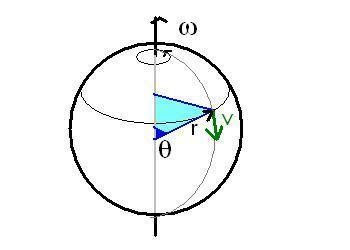

Yes, omega is the angular velocity of Earth. The train travels due to South along the surface of the Earth. The position is Edmonton. Use polar angles or longitudes and latitudes as coordinates. What is the magnitude of the position vector r?

|r| = 6400.
the position vector is then r = 6400cos λ i + 6400sin λ j. But what confuses me is the i* j* k* vectors are all over the place. the problem is so easy as it's just a matter of plugging and playing but different frames of reference make these position vectors hard to find in the right frame.

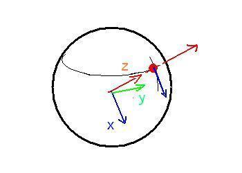

Centrifugal force and Coriolis force appear in the rotating frame of reference. The subject of these forces is the train now, they are exerted on the train and observed by somebody, standing on the ground, rotating together with the Earth. You can set up a coordinate system, appropriate for the observer on the Earth: with x-axis to the East, y to the South and z axis up, for example. What are the components of omega in that system of coordinates?
Or you can choose ω as the z axis, pointing towards the North Star. The train moves along a circle of radius ρ depending on the latitude, perpendicular to the axis of the Earth. You can choose one axis tangent to the circle (to East or West) and the third axis perpendicular to the other two. What angle does this axis enclose with the vertical?
Answer giving the forces in terms of the bearings , North-South, East-West and with the angle they enclose with the vertical. (Vertical is parallel with the radius of Earth)Anyway, you have to give the direction of the forces with respects tp the Earth, in terms of East-West, North-South, up or down...ehild
Let me define my non-inertial coordinate system, with basis vectors i*, j*, and k*. I want i* to point due south, j* to point due east, and k* to point perpendicular to the surface of the Earth where the train is.
Then we can express ω in terms of these basis vectors as follows:
\boldsymbol{\omega} = \omega sin \lambda \textbf{k}^{*} - \omega cos \lambda \textbf{i}^{*}
And
\textbf{r}^{*} = 6400 sin \lambda \textbf{k}^{*} + 6400 cos \lambda \textbf{i}^{*}
but when i go to find the Coriolis force, I'll need v*, which should be the time derivative of r* above. Am I totally lost? Feels like I am.
ω=ωsinλk−ωcosλi
And
r∗=6400sinλk+6400cosλi
r* is perpendicular to the surface of the Earth, so it is parallel to k*.

what's confusing is that if v* = 300i*, then my entire i* j* k* is moving with the train at all times, and thus r = 0 always. i don't see how r* = k*.
The frame of reference is fixed to the Earth, it does not move with the train. You can put the origin into the centre of Earth, with the x and y-axis parallel to the South and West directions in Edmonton. It is a rotating frame of reference then. You need to determine the magnitude and direction of the centrifugal force and those of the Coriolis force when the train is at some point in Edmonton, so r=6400 km.
If you place the origin at the location on the train in Edmonton, so r=0, the frame of reference is both traveling along a circle (therefore accelerating towards the centre) and rotating. Then you have to take the fictitious force -ma into account where a is the centripetal acceleration on the latitudinal circle.
