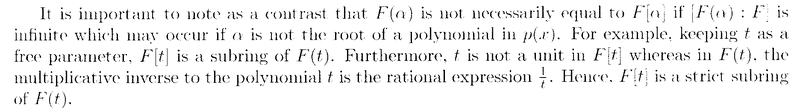

The remarks pertaining to Theorem 7.1.10 read as follows (page 326) :
Printed text on a page from a textbook discussing field extensions: F(alpha) is not necessarily equal to F[alpha] if [F(alpha):F] is infinite, with an example using t as a free parameter, F[t] a subring of F(t), and t not a unit in F[t] while 1/t is in F(t).
I do not understand the use of 't' in the above text ... nor do I fully understand the analysis involving it ...
My specific question is as follows:
In the above remarks, Lovett writes the following:
" ... ... For example keeping ##t## as a free parameter, ##F[t]## is a subring of ##F(t)##. ... ... "What is ##'t'## and why exactly are we introducing it?
Why not stick with ##x## and ##F[x]## and ##F(x)## ... ... ?
I note that Lovett does not usually introduce a "free parameter" (whatever that is?) and happily deals with the indeterminate ##x##... ... ?? ... ... so ... indeed, one may ask when is a "free parameter" necessary and when is it not needed ...

In general ##\mathbb{F}[.]## denotes a ring over ##\mathbb{F}## and ##\mathbb{F}(.)## denotes a field, the quotient field of ##\mathbb{F}[.]##.
In case it is ## \mathbb{F}[t]## or ##\mathbb{F}[x]## we usually mean indeterminates, i.e. a variable ##t## or ##x## and polynomial rings where ##t^{-1} \notin \mathbb{F}[t]## and ##x^{-1} \notin \mathbb{F}[x]##, and their quotient fields where ##t^{-1} \in \mathbb{F}(t)##, resp. ##x^{-1} \in \mathbb{F}(x)##.
The indeterminates behave like transcendental numbers, as they don't obey any algebraic equation. The only difference is an intuitive one: we do not replace numbers - algebraic or transcendental - by other numbers, but we are used to replace indeterminates by numbers, such as ##\mathbb{F}[x] \longrightarrow \mathbb{F}[\sqrt{2}]##.
Now what the author means is, that ##\mathbb{Q}[\pi]## and ##\mathbb{Q}(\pi)## are not the same algebraic object. The first is only a ring, an infinite ring extension of the rationals, because ##\frac{1}{\pi} \notin \mathbb{Q}[\pi]##, whereas the second is a field: ##\frac{1}{\pi} \in \mathbb{Q}(\pi)##.
On the other hand, the situation changes, if we talk about algebraic numbers. In this case is ##\mathbb{F}[\alpha] = \mathbb{F}(\alpha)##.
Can you show, why ##\frac{1}{\alpha} \in \mathbb{F}[\alpha]## if ##\alpha## is algebraic over ##\mathbb{F}##?

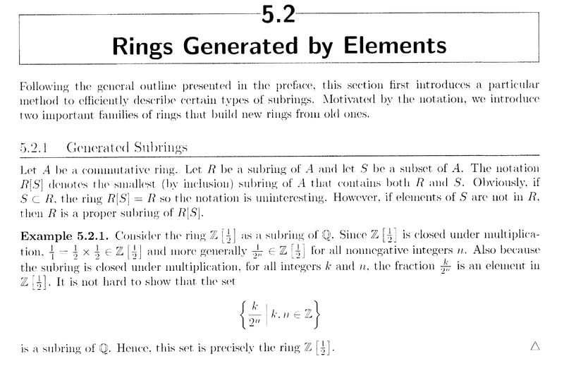

I just thought I would present Lovett's explanation of ##F[ \alpha ]## and ##F( \alpha )## ... and also ##F[x]## ...
Lovett's first significant mention of such symbols is in Section 5.2: Rings Generated by Elements (pages 216 - 225) ...
In Section 5.2.1 Generated Subrings, Lovett defines ##R## where ##R## is a subring of a commutative ring ##A##, and ##S## is a subset of ##A## ... ... as follows:
Textbook page titled 5.2 Rings Generated by Elements, showing Section 5.2.1 Generated Subrings and Example 5.2.1 on the ring Z[1/2] as a subring of Q, with the set {k/2^n | k, n in Z}.

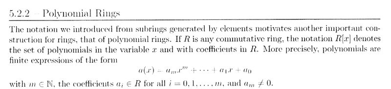

Lovett then goes on to define polynomial rings ##R[x]## ... in section 5.2.2 ...
The start of Section 5.2.2 reads as follows:
Textbook page section 5.2.2 Polynomial Rings: defines R[x] as polynomials in variable x with coefficients in R, and displays a(x) = a_m x^m + ... + a_1 x + a_0 with m in N, a_i in R, and a_m nonzero.
Lovett then goes on to define/discuss addition and multiplication of polynomials ...
I note that in defining polynomial rings Lovett uses the term "the variable ##x##" and not the mysterious term "indeterminate" for ##x## ... ... In the context of fields, Lovett mentions ##F[ \alpha ]## and ##F( \alpha )## in Section 7.1 Introduction to Field Extensions ... . The reference is in the context of ways to construct some field extensions ... and reads as follows:

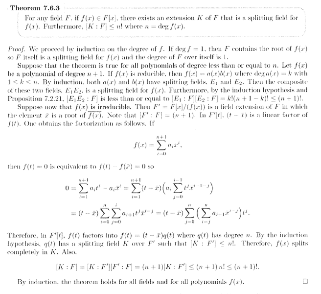

In order to further clarify my puzzlement at the differences between ##F[x]## and ##F[t]## I thought i would present the theorem which first convinced me I need a better understanding of t as a "free parameter" ... ...
The Theorem concerned is Theorem 7.6.3 in Lovett, Section Splitting Fields and Algebraic Closure ... ... the theorem and its proof read as follows:
Page of a textbook showing Theorem 7.6.3 on splitting fields, its proof by induction on the degree of f, and the factorization steps involving f(t) and f(x bar).
In the text above from Lovett, in the third paragraph of the proof, we read the following:
" ... ... In ##F'[t], (t - \overline{x} )## is a linear factor of ##f(t)## ... ... "
I am not sure why we are introducing ##t## ... and, further, I am not sure of the nature of ##t## ...
Is it just a variable in ##F'## where we want to distinguish it from ##x## which is a variable in ##F## ... is that all there is to it ..
Mind you, later we read ...
" ... ... If
##f(x) = \sum_{ i = 0 }^{ n + 1 } a_i x^i##
then ##f(t) = 0## is equivalent to ##f(t) - f( \overline{x} ) = 0## ... ... "
I cannot see why ##f(t) = 0## is equivalent to ##f(t) - f( \overline{x} ) = 0## ... ... ?Can you help?
Peter

OK it's starting to take shape now. This is how it looks to me, based on yours and fresh's posts:
  • Let ##F## be a field that is a sub-field of field ##E##.
  • Let ##\alpha## denote an element of ##E-F##. In what follows ##we can replace ##\alpha## by any letter other than ##x##
  • ##F[x]## denotes the ring of polynomials with coefficients in ##F##. In this notation, the use of ##x## is essential. It cannot be replaced by any other letter, unless the author provides their own definition about what they mean by that.
  • ##F(\alpha)## denotes the field generated by ##F\cup\{\alpha\}##. It will be a subfield of ##E##.
  • ##F[\alpha]## denotes the ring generated by ##F\cup\alpha##. This is a subring of ##F(\alpha)## because the latter is the field generated by the generators and the former is the ring generated by them. Field generation generates a (not necessarily strictly) bigger set than ring generation because it includes the creation of inverses, which ring-generation doesn't.
  • When Lovett writes ##F[\alpha]=F(\alpha)## he is saying that, given the premise that ##[F(\alpha):F]## is finite, ring generation gives the whole field.
When Lovett writes ##F[t]## or ##F(t)##, he is trying to indicate that ##t## is a general element of ##E-F##. But I don't think he needs to change letters to do that, as no particular properties have been ascribed to the symbol ##\alpha##.
So when he says for instance that '##t## is not a unit of ##F[t]##' he is just saying that, for any ##t\in E##, the ring ##F[t]## does not necessarily contain a multiplicative inverse for ##t##. Nor would we expect it to, since the creation of mult inverses is not part of the ring generation process (unlike the field generation process). If ##t\in F## it will have a mult inverse in ##F[t]##, because ##F\subseteq F[t]## and ##F## is a field. But if ##t\in E-F##it will not necessarily have a mult inverse in ##F[t]##,
We can replace the ##t##s in the previous para by ##\alpha##s if we like.
