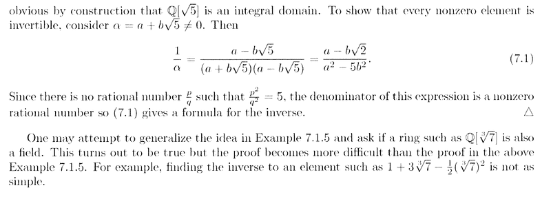

I am reading Abstract Algebra: Structures and Applications" by Stephen Lovett ...
I am currently focused on Chapter 7: Field Extensions ... ...
I need help with the proof of, or at least some remarks concerning Example 7.1.5 ...Example 7.1.5 reads as follows:
In the above text from Lovett, we read the following:
" ... ... Then ##\mathbb{Q} [x] / ( p(x) ) = \mathbb{Q} [ \sqrt{5} ]## is a field. ... ... "
I understand that ##\mathbb{Q} [x] / ( p(x) ) = \mathbb{Q} [x] / ( x^2 - 5 ) ## is a field ... ... but why is it equal to ##\mathbb{Q} [ \sqrt{5} ]## ... ... ?Can someone please explain and demonstrate why the equality ##\mathbb{Q} [x] / ( x^2 - 5 ) = \mathbb{Q} [ \sqrt{5} ]## holds ... ?Help will be appreciated ...

I think perhaps he means to indicate the two rings are isomorphic rather than equal. Set-theoretically they are distinct objects.
The function ##\psi:\mathbb Q[\sqrt 5]\to \mathbb Q[x]/(p(x))## given by ##\psi(a+b\sqrt 5) = (a+bx)+(p(x))## looks promising to me as a potential isomorphism.

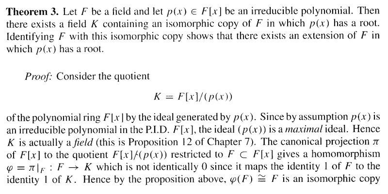

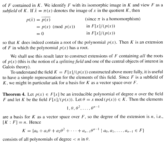

So ... been reading Dummit and Foote Chapter 13, Field Theory ... and in particular Theorems 3 and 4 on pages 512-514 ... (see below)
So ... interpreting Lovett Example 7.1.5 in terms of the notation and ideas of D&F Theorems 3 and 4, Chapter 13 ...
... we have ...
##p(x) = x^2 -5## is irreducible in ##\mathbb{Q} [x]##
and ##K = F[x] / ( p(x) ) = F[x] / ( x^2 - 5 )## is a field with root ##\overline{x} = x \text{ mod } (x^2 - 5 )##
... BUT ...
... how do we (formally and rigorously) demonstrate that ##\overline{x} = x \text{ mod } (x^2 - 5 ) = \sqrt{5}## ... ...Since i find this difficult/awkward to do ... I feel I am not fully understanding the concepts and mechanics involved ...
Can someone please help ...
Peter
I have referred to Theorems 3 and 4 of D&F Chapter 13 ... The statement and proof of Theorem 3 plus the statement of Theorem 4 follows:
