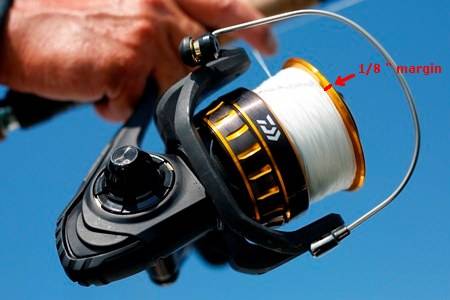

I need help on figuring how to fill a spool on a spinning reel with two different diameter fishing lines.
BACKGROUND INFO:
The Daiwa BG3000 spinning reel’s spool can hold 240 yds of 20 lb J-Braid line.
The Daiwa J-Braid X8 Grand line comes 300 yds on a spool.
J-Braid X8 Grand 20 lb line is considerably more expensive than 20 lb monofilament line.
The diameter of 20 lb mono line is bigger than the diameter of 20 lb braid line.
WHAT I WANT TO DO:
I want to fill the reel’s spool with 20 lb test monofilament line first. (Called “filler” line”) Then fill the rest of the reel’s spool with 150 yds of the 20 lb test J-Braid line. The object is to fill the reel’s spool so that when there is 1/8” margin left on the spool as shown in the picture below, that will be 150 yds of braid line used:
NEED HELP ON THE CALCULATION:
If the reel’s spool is rated to hold 240 yds of 20 lb braid line, how much of the outer diameter of the spool takes up 150 yds of line when it just reaches the 1/8” margin?
Put another way, how much of the spool should I fill with the mono line so that the remainder of the spool will use 150 yds of braid line?

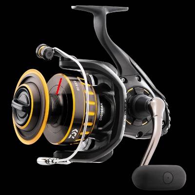

The red line indicates the “depth” of the spool with the 1/8" margin. What percentage of the red line should I fill with mono line so that the balance of the red line will use about 150 yds of braid line?
I’ve ordered the reel but have not received it yet so I can’t measure the actual dimensions of the reel’s spool. But the actual dimensions may not be needed for this calculation in percentage of the red line.

The volume of a cylinder is ##L\ A=L \ \pi r^2##. So the volume of braided line that the reel can handle is
##240 yd * \pi * (0.23/2)^2 mm^2 = 9.97 yd*mm^2##
(I know it is a weird unit of volume, but it is fine as long as we are consistent).
If you fill it with 150 yards of braid then that takes
##150 yd * \pi * (0.23/2)^2 mm = 6.23 yd*mm^2##
so you have 3.74 yd*mm^2 of volume left for the mono-filament.
So solving
##3.74 yd*mm^2 = L * \pi * (0.45/2)^2 mm^2##
gives L = 23.5 yd

My concern is that the inner diameter of the reel's metal spool before any line is installed, (call it the core), is small compared to the outer diameter.
So let's assume that the entire spool is filled with 20 lb braid line (no mono filler). The braid wound on the spool in the beginning is being wound on a small diameter core. As the spool is gradually filled with line, the diameter of where the line is being wound on is getting larger and larger. Therefore looking at the red line in picture-2, maybe 30% of the outer portion holds an equal amount of line as the inner 70% of the red line. (Just made up percentages as I have no idea of the correct percentage difference.)
Hope I explained my concern clearly enough to understand what I mean.
Thanks!
Yes, you explained the concern clearly. You don’t need to worry about it. A given amount of line will take the same amount of volume on the spool regardless of if it is the part of the volume next to the spool or on the outside of the spool. What matters is the volume.
