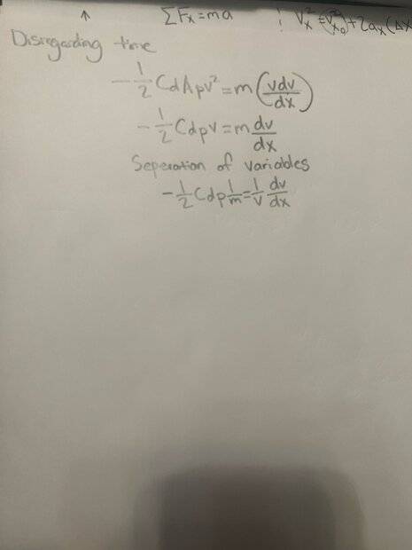

vbottas said:
taking one v out from both sides correct?
Yes, that's right. :smile:
Now the rest is straight calculus. Start with separation of variables.

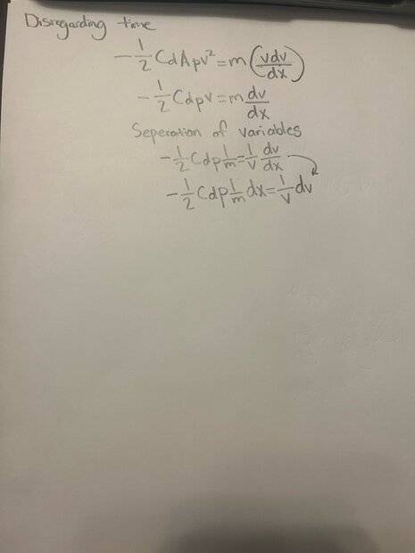

collinsmark said:
Yes, that's right.
vbottas said:
Looks good to me so far. But move the [itex]dx[/itex] to the other side of the equation. Then you'll finally be ready to integrate.
should I plug in known values to the left side?
Always try to work in variables till the end. Calculate as last step.
erobz said:
Alway try to work in variables till the end.
ok! I was just worried taking the integral this many constants labeled as letters may get a bit confusing. But I'll trust you on this!
The constants come outside the integral.

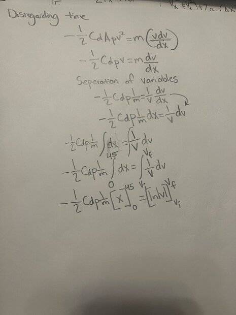

collinsmark said:
Perfect. :smile: Now integrate both sides of the equation. (This will involve two integrals, one on each side of the equation.)
the bounds on the left side is 0 to 45 correct? what would my right side bounds be?
vbottas said:
the bounds on the left side is 0 to 45 correct? what would my left side bounds be?
Well, you're integrating over velocity, right? How about [itex]v_f[/itex] and [itex]v_0[/itex]?

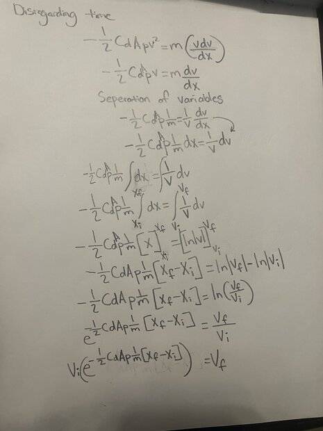

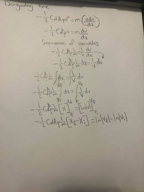

vbottas said:
So far so good, except you left out the [itex]A[/itex] by accident somewhere along the line. But yes, that's the right idea.
Next step is algebra. Solve for [itex]v_f[/itex].
Now use log rules and solve for ##v_f##
erobz said:
Keep simplifying
I can turn the rhs to ln(vf/vi) but that is the only simplificiation I see? Do you agree?
Next. exponentiation of each side.
Try taking both sides of the equation to the power of e. (I.e., exponentiate each side)
oh boy its been awhile since i've done this. the rhs ln disappears leaving just vf/vi. but for the left side, does all of the left side become the exponent for e?
Yes.
