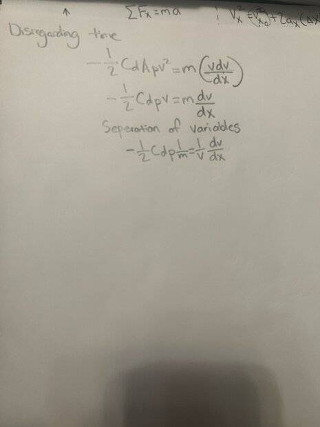

How do I find the final velocity of a car moving initially at 30.63 m/s after it has moved 45m. Over the 45 meters, It has only 1 opposing force, drag force. Ignore the force of static friction propelling it foward. However, this drag force is decreasing since this car is slowing down so this drag force is not constant throughtout the 45m. Here is the data, mass of car is 1565m, density of air is 1.3, drag coefficient of the car is 0.20, cross sectional area is 8.71 m^2.

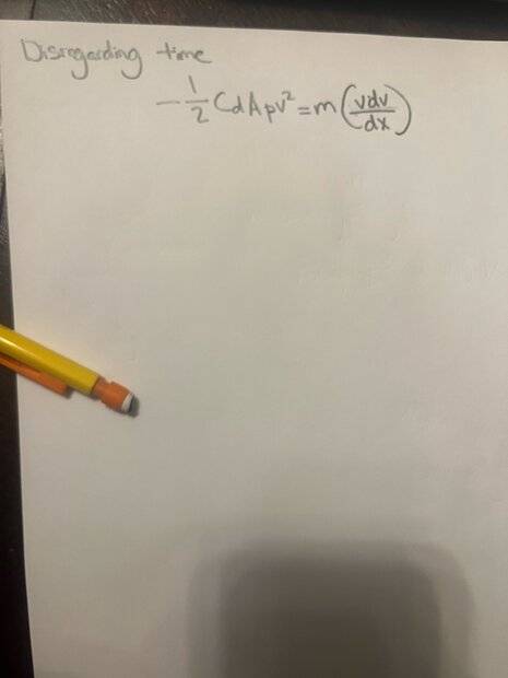

I apologize. Yes that is a typo. m(vdv/dx) is what I meant to type
Yes, that's right! :smile:
Now, incorporate that into your equation. As a special bonus, you should now be able to simplify it a bit before the next step.

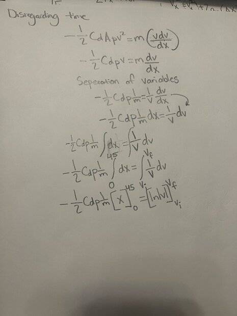

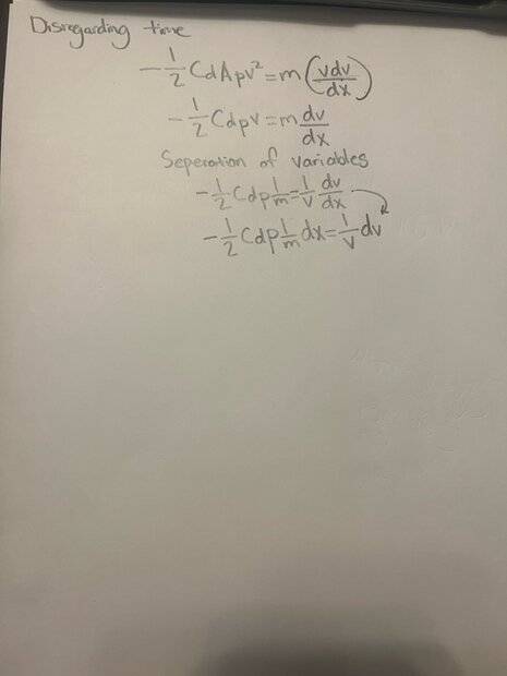

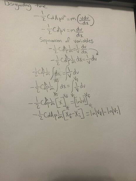

taking one v out from both sides correct?
vbottas said:
Yes, very nice. But do you see a way to simplify that a little? (Do you see any variables that cancel?)
