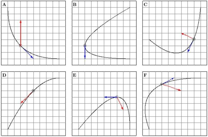

Rank the rate at which the direction of each object's velocity is changing, greatest first.
n/a
I know a centripetal = v^2/r, but i don't have r so i am not sure if i am supposed to just eyeball it and draw a reference circle or not..

The objects don't move on a circle, and they don't move at uniform speed either.
What is plotted here? Two spatial dimensions? Blue is the motion I guess. Can you figure out what red is?

Red is acceleration here I'm sorry i forgot to mention

Okay (although it looks odd in (b), there should be an acceleration).
For the change in direction the acceleration along the direction of motion does not matter. Can you find the acceleration orthogonal to it?
