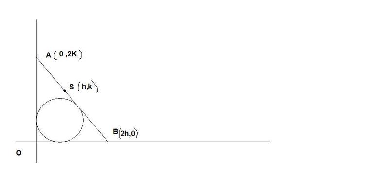

The circle x2 + y2 - 4x - 4y + 4 = 0 is inscribed in a triangle, which has two of its sides along the coordinate axes. If the locus of the circumcentre is of the form
x + y - xy + k(x2 + y2)1/2= 0. Find k.
The centre of the given circle is (2,2) and its radius is 2 units. Let the circumcentre be (h,k).
The intercepts of one side of the triangle on x and y axes are 2h and 2k respectively.
The distance between incentre and circumcentre is (R2 - 2Rr)1/2, where R = (h2 + k2)1/2
Square of it must be equal to (h -2)2 + (k -2)2
i.e. (R2 - 2Rr) = (h -2)2 + (k -2)2
On solving I got
h + k - (h2 + k2)1/2 = 2
which is not of the form given.
Please point out my mistake if any.
how do you get that?
For a right angled triangle, the circumcentre lies on the mid-point of the hypotenuse.
Let the vertices of the triangle on x and y axes be (x,0) and (0,y) resp.
Using the midpoint formula, we get x=2h and y=2k, which are the intercepts of one side of the triangle (hypotenuse) :smile:

How does the circumcentre lie on y= -x?
Refer the figure.

ok, now as vertigo says, since the question isn't asking you to prove the equation, it's easiest to choose just one triangle …
and the easiest one to choose will be the one with h = k, ie the one with the line parallel to x = -y, since the circumcentre of that triangle is obviously at … ? :smile:

Now can anybody point out my mistake in finding out the equation of the required locus? or possibly suggest another approach for finding the equation?
Your line defined by h and k is a completely general line …
you need to restrict it so that it is tangent to the circle. :wink:
(in fact, that restriction will probably be an easier way of finding the locus than using the distance between the two centres)
Ah, I see. The restriction is that the perpendicular distance of the line from the centre of the circle is 2 units :smile:.
Thank you tiny-tim!
I got the answer :wink:
