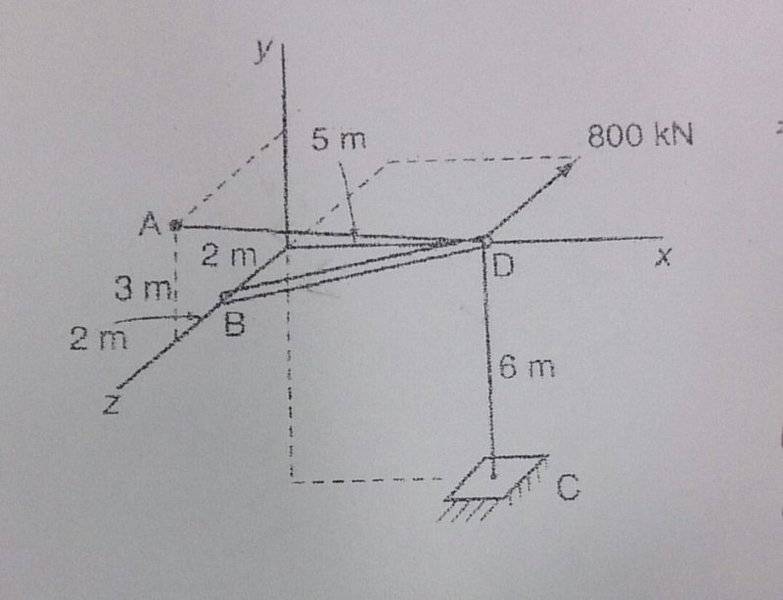

I am asked to find the load in AD, BD, and DC...
I have AD(2/surd38) +BD(2/surd29)=800
AD(3/surd38)=DC
I can only formed two equation... But , so many unknown... How to solve this?
Here's the diagram
AD(3/surd38)=DC
Instead of just writing down a random equation, you should:
1. Write down the known information in a logical order
2. Write the general equations of static equilibrium (ΣF = 0; ΣM = 0)
3. Analyze the problem to determine if there are simplifications or special conditions which may apply.
4. Write the equations of equilibrium for this problem.
5. Solve these equations to determine the unknown reactions / internal loads.
For this problem, you could first calculate and write down the lengths of the members involved: the bar BD and the lines AD and CD.
Step 2 is pretty much taken care of.
Step 3: The bar BD can take either tension or compression. The lines AD and CD look like they can take only tension. There is only one applied load of 800 kN.
Here's the critical step:
Write the equations of equilibrium for this structure after completing steps 1-3.

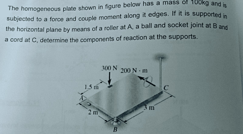

how do u knw The bar BD can take either tension or compression. The lines AD and CD look like they can take only tension??since this is an exercise that involves 3D , then we can only consider moment about x , y and z axis , right ? we can't consider moment about a specific point ?
I don't know what "moment about a point" means. You can evaluate moments only about an axis.
moment about a point means we simply pick a point , and claculate the moment at it . For example , we take the point A , and we calculate the moment ( force x distance ) about it .
You can calculate moments about an axis which passes thru a point, but you can't calculate moments about a single point. :wink:

I have ΣFx = -AD(5/surd38) -BD(5/surd29) =0
ΣFy = AD(3/surd38)-DC=0
ΣFz= BD(2/surd29) +AD(2/surd38) -800= 0

You might want to check the x, y and z-components of AD and the length of AD.
i couldn't see what's wrong with it
Look again at the diagram carefully. The length you have calculated for line AD is incorrect.
What's the location of point A?
The z coordinate for B is 2, for A is 4?
And the length of line AD is?
Surd50... The diagram is unclear
Seemed pretty clear to me. :wink:
The 2 m looks like B to Z
The dashed lines have some significance in the diagram here.
There is no purpose in locating the position of the letter Z; there is a purpose in locating the position of point A.
here's a case . it give the moment about the x , y , x' and y' axis ... but not moment about a specific point
so when we are asked to find the moemnt for a question involving 3D model , we can only use the moemnt about a specific axis to find the moment ? but not a specific point ? (for example. in the above case , we cannot find the moment about the O ( centroid) ) ?
No, moment about a point is valid. It will be a vector, defining its own axis.
When you take moments about a selected axis, you get the component of the full moment vector parallel to that axis.
Re =post #20: That's right. In 3D there are a lot of rotation axes you can think of for O, so you have to specify which one.
Haru is right in post #21 in the sense that one can add moment vectors. The result is a sum moment with a sum axis. But for your exercise it's more effective to look at the magnitudes of the moments about separate axes one by one. No rotation means they all need to be 0.
