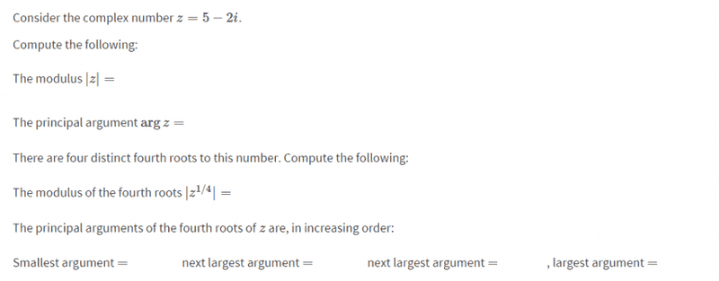

First question = attached below

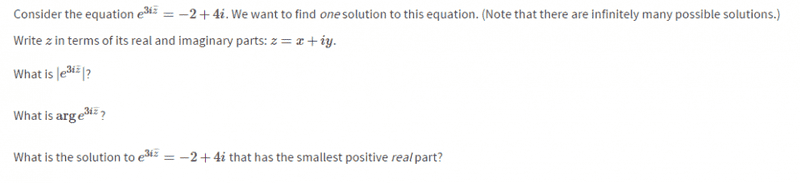

Second Question = attached below
modulus, argument, roots.
For the 1st question I've gotten the modulus, the principal argument and the abs. of z^1/4 which was something like 1.5335 I believe. The only thing I am not understanding with regards to this question is the final part, where it is asking for the smallest argument, 2nd smallest, 2nd largest and largest in that ascending order.
I've tried several things but none of them have worked to give me a proper answer. I'm probably missing something really stupid like "Just divide it by x to find smallest, add x to find largest, take away x to find second smallest" or some standard format like that.
2nd question I got these as my answers
1: e^(3x)
2: -3y
3: -(i*arg(-2+4i))/3 + ln(abs(-2+4i))/3
yet they don't seem to be the correct answers, I think I must be leaving out a step in the 2nd one.

I suggest that these should be posted two threads, one thread for each problem. They are not all that similar, and each is multi-part.
It would be helpful to post the images as full-size like this:
When you are asked to calculate something like z1/n, you should be aware that there are n separate and distinct complex numbers, call them w1, w2, w3, ..., wn, which result. These complex numbers are related to what are known as the roots of unity, which is described here:
https://en.wikipedia.org/wiki/Root_of_unity
If you express the original complex number z in its polar form, such that z = r e i θ, then the various values of z1/n can be easily computed.
