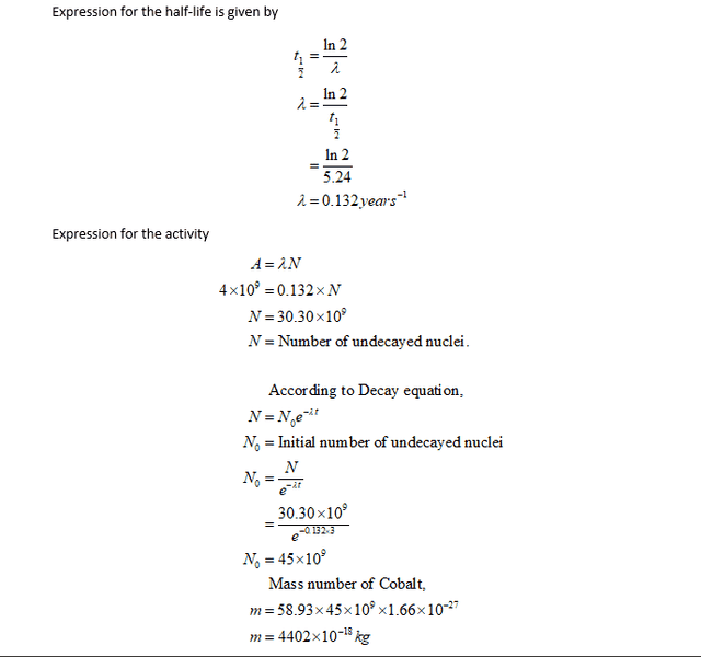

So I need that in micrograms tho. So 4402*10^-18/1000=4.4*10^-18kg. or 4.4*10^-12 micrograms
that stills say it's wrong tho.

Perhaps you should use the activity equation A(t) = A0 e-λt to find the initial activity A0 and convert that to the initial number of nuclei.
Didn't we do that at the bottom of the image?
Watch units. A bequerel is defined how?
I don't follow your conversion of kg to μg.

Not really. To reinforce what @TSny posted, assuming that you found A0, what is the number for λ in N0 = λ A0 when A0 has Bq units?

I asked about the bequerel because your λ is in terms of years.

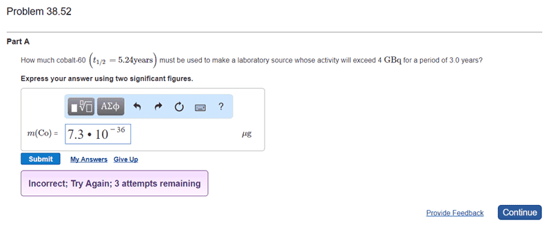

I was not able to figure this out. Any help on where I went wrong is appreciated. So I'm guessing I did the -.1322 wrong based on what you guys have mentioned.
Look at the equation A = λ N. Put in the numbers including the units attached to each number. Then you will see what is going on.

4*10^9 Bq =.132yr^-1*N
or
4*10^9Bq = 4.18291693 × 10-9 Bq * N
N= 9.56*10^17
9.56*19^17/e^(.132*3) = 6.43*10^17
(6.43*10^17)(1.66*10^-27)(58.93) =6.28*10^-8kg or 6.3ug
That's better but still incorrect. What does N= 9.56*10^17 represent? What about 6.43*10^17? What number is that? If N is the number of undecayed nuclei, after 3 years (when the activity is 4*10^9Bq) and 6.43*10^17 is the initial number of undecayed nuclei, which one should be the larger number? Also, what are the units of 1.66*10^-27 and 58.93?
So Muliplying 1.66*10^-27 and 58.93 converts mass number of Cobalt from amu to kg.The Initial should be bigger.
Just realized I may have had it right but I forgot to convert the kg to g. So my answer should have been 6.28ug

I agree, but when you start with the equation A = λ N, then you say A = 4*10^9Bq, that "A" is the final A and the number N = 9.56*10^17 that you get from it is the final N. So, what is the initial N that should be larger than 9.56*10^17? That's why I suggested that you find the initial activity in post #2.
I prefer to look at it this way: If you have N atoms of atomic weight AW, the mass of the sample is given by
$$m=AW \left(\frac{grams}{mole} \right)\times N (atoms) \times \frac{1}{N_{Avog.}} \left(\frac{mole}{atoms} \right)=AW\times \frac{N}{N_{Avog.}}(grams)$$
It's not a coincidence that the inverse of Avogadro's number (1.66×10-24) matches the mass of a proton (or neutron) in grams, 1.67×10-24.
