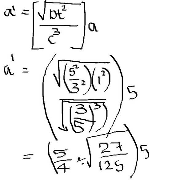

a is proportional to square root of (b *t2)
a is proportional to 1/c3
a is 5, when b = 9, t = 2, c = 3
Find a' when b'=25, t'=2, c'=5
My attempt:
= (25 root 5/12 root 3) 5
I think my steps are wrong, can someone help me!?
I think you are getting confused by the a / a' notation.
Let's start with this part. This means, that a contains both those factors, so you can write it as
[tex]a(b, t, c) = \frac{\sqrt{b t^2}}{c^3} \cdot k[/tex]
The k here is some constant number (the proportionality factor). Note that I have written the left hand side as if it were a function of b, t and c.
Now, you know that a(b = 9, t = 2, c = 3) equals 5, you can use that to calculate the proportionality constant k.
