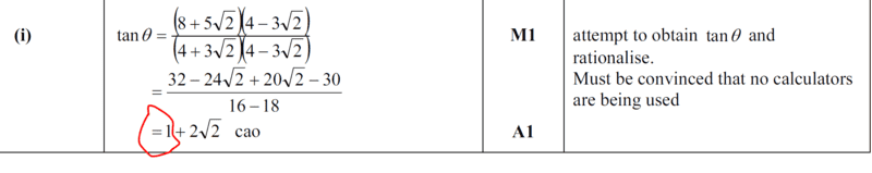

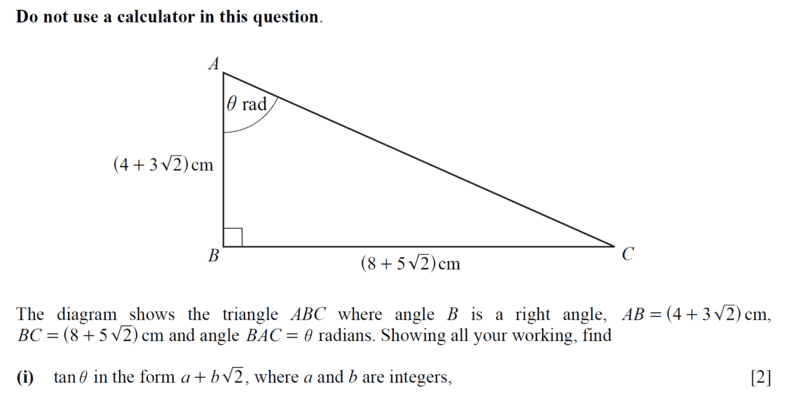

see attached.
Trigonometry - Add Maths
There is an error on ms ...unless i am missing something.
chwala said:
Homework Statement: see attached.
Relevant Equations: Trigonometry - Add Maths
Yes. There is an error.
Showing the intermediate step where you group the radicals and simplify the denominator may help reveal the mistake.

I saw the mistake ... just wanted to counter-check myself... Cheers man!
This is a question from an international curriculum paper and its highly unlikely for mistakes to be on ms ...
