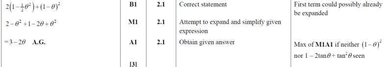

Show that ##2 \cos \theta +(1- \tan \theta)^2≈ 3 - 2\theta##
trigonometry
This is a past paper question...
find the solution here from ms
...wawawawawa...it took a little bit of my time because i was only thinking of taking limits...then realized that i was wrong as we have to remain with ##2θ##...i later realized that for small approximations, ##\cos θ≈1-\frac {1}{2}θ^2, \tan θ≈θ##.
Is there a different way of solving this problem?
Term order of 1 comes as 2+1=3
Coefficient of ##\theta## comes as 0-2=-2
Coefficient of ##\theta^2## comes as -1+1=0
Coefficient of ##\theta^3## comes as 0+0=0
and so on.
When we write the formula
[tex][2\ cos\theta+\sec^2\theta]+[-2\tan\theta][/tex]
=[even function of ##\theta##]+[odd function of ##\theta##]
All the even power terms come from the first term. All the odd power terms come from the second term and it is easy to get.

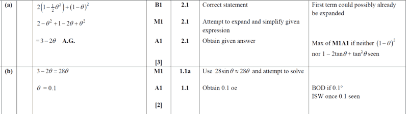

This is the continuation of the question...part (b)... i really am not getting how they are solving this...the angles are in radians...approximation is their approach...

chwala said:
any better way?
I doubt it. In this part, as in the first part, they're assuming that ##\theta## is reasonably small, so ##\sin(\theta) \approx \theta##.
Using the result of the first part of the problem, we have ##3 - 2 \theta = 28\sin(\theta) \approx 28\theta##. The result follows almost immediately.
Noted ...cheers Mark.
It would have been helpful to include, in Post #1, a statement about θ being a small angle.
