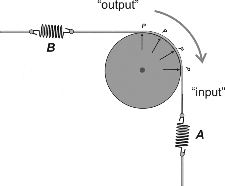

Since it's all one rope the tension is constant - because if part of the rope was more tense than the part next to it, it would pull on the less tense part until the tension was the same in both places.
The pulleys are pushing sideways on the rope, so they cannot disturb the tension that do exist in it. It is only when the pulleys exhibit friction that they can change the tension from the "input" to the "output" side of the rope. That is you need to pull harder on the input side of the pulley resulting in less tension being transferred to the output side (that is the pulley is resisting the transferrence of tension from the one to the other side and some of it is used to ovecome the friction generated by the pulley - that is the pulley do not turn freely on its axis and therefore also pulls on the rope).

No. The rope is rolling over the pulley. It rotates as the rope passes over it. The rope is always tangential to the surface of the pulley, so the surface of the pulley can only push sideways on the rope as it passes over it. It cannot push or pull in the direction of the rope since the rope is rolling over the edge of the pulley.
If you pass 1 meter of rope over pulley a towards pulley B pulley B will drop by only half a meter since pulley B will hang in the middle of this extra one meter length that came over to its side.

As the rope wrap around the pulley it presses sideways on the rope - the P forces on the rope. These forces are acting perpendicular to the tension in the rope, therefore they cannot alter the tension in it. The situation is similar to that of a projectile in free flight. The weight of the projectile do not alter its horizontal motion. It is only its vertical motion that changes as a result of the gravitational attraction.
