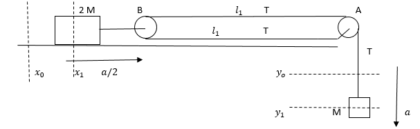

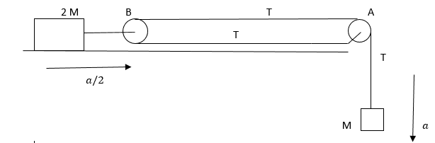

Consider the situation shown in figure. Both the pulleys and the string are light and all the surfaces are friction-less. Find the acceleration of the mass M and the tension in the string in the
figure given below.
Free-body diagrams and the forces acting on them.
I solved this problem by assuming that the acceleration ##a## is the same on the both the masses M and 2M but then answers were wrong, but if the acceleration of the mass 2M is considered as ##a/2## then I get the right answers, but I don't how exactly acceleration is getting halved for mass 2M.
How do I show that the acceleration of the mass 2M is ##a/2## if the acceleration of M is ##a## ?

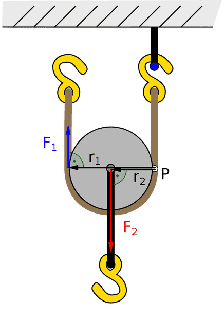

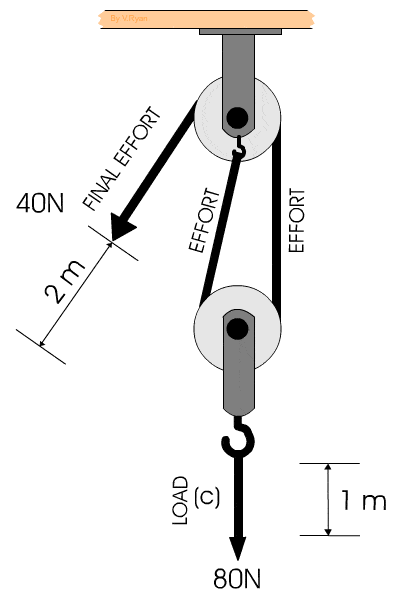

Can you visualize pulley B as being a lever with pivot located at the lowest point, load located at the middle point and working force located at the highest point?
Then, combine that idea with the mechanical advantage concept: what you gain in force, you lose in displacement.

By using the fact that the string has constant total length.
Write an expression for the length of the string in terms of the locations of the masses and differentiate it wrt time a couple of times.

If you move mass ##M## by ##1## unit, then mass ##2M## moves by ##0.5## units. That's a constraint on the motion.
Note that if you pushed mass ##M## up, then mass ##2M## would not move. Again, in that case, an assumption of equal accelerations would be wrong.

Ignoring the pulley radius.
##{x_0}## and ##{x_1}## are distances from mass 2M to pulley B, they are constants.
##{y_0}## and ##{y_1}## are the distances of mass M from pulley A.
##{l_0}## and ##{l_1}## are the distances between the pulleys A and B with respect to positions ##{x_0}## and ##{x_1}## of mass 2M and ##{y_0}## and ##{y_1}## of mass M respectively.Let the total length of the string be ##L##
##L = f(y, l)##
##L = 2{l_0} + {y_0}##
##L = 2{l_1} + {y_1}##
## L = 2l + y ##
Differentiating the above with respect to time
## \frac{dL}{dt} = 0 = \frac{2dl}{dt} + \frac{dy}{dt} ##
## \frac{2dl}{dt} + \frac{dy}{dt} = 0 ##
The above means ## 2({l_1} - {l_0}) = {y_1} - {y_0} ## in the time interval ##t## right ?
##L = f(x, y, l)##
##L = 2{l_0} + {x_0} + {y_0}##
##L = 2{l_1} + {x_1} + {y_1}##
## L = 2l + x + y ##
## \frac{dL}{dt} = 0 = \frac{2dl}{dt} + 0 + \frac{dy}{dt} ##

So half of ##\Delta y## of the string moves towards the pulley B from under it and the other half moves away, over it, summing up to ##\Delta y## length of string moving towards right, so the distance moved by the pulley is ##\frac {\Delta y}{2}## is this how you see it ?
Yes, the string runs twice between ##A## and ##B##. If ##B## moves ##1 \ cm## closer to ##A##, then you lose ##2 \ cm## of string.
