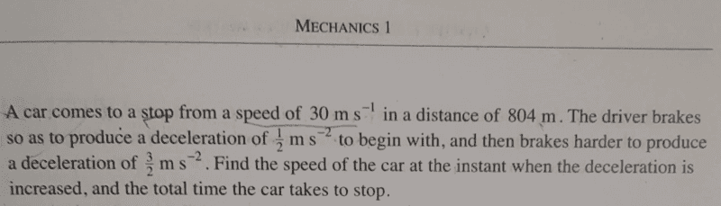

Find the question below;

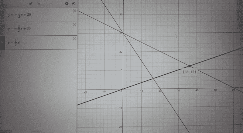

Now the car changes its acceleration at some point i.e from ##-\frac{1}{2}## ##m/s^2## to ##-\frac{3}{2}## ##m/s^2## ...
I considered the following graphs for the two equations, assuming that the second equation was also starting from the point ##v=30####m/s##
Now the graph of ##v=30-1.5t## will give us some perspective on how it relates to the graph of ##v=30-0.5t## at some point...noting that the desired graph will be parallel to ##v=30-1.5t##.
Now i attempted to find the scale factor ##m## connecting the two functions by letting,
##-\frac{3}{2}##m = ##-\frac{1}{2}##
##→m##= ##\frac{1}{3}## therefore plotting the graph,
##v##= ##\frac{1}{3}t## realizes the point that we were looking for where, ##(t,v)##=##(36,12)##
Therefore, the speed of the car at the point where deceleration is increased is ##12## m/s and the time taken for the car to stop is given by
using ##v=u +at##
##0 ##= ##12##+ ##-\frac{3}{2}####t##
##t=8##, therefore time taken for car to stop is ##36+8=44##seconds
bingo guys:cool::cool::cool:
There may be a better approach to what i have done...
The answer is correct, but I don't get the logic here:
chwala said:
Now i attempted to find the scale factor m connecting the two functions by letting,
−3/2 m = −1/2
→m= 1/3 therefore plotting the graph,
v= 1/3 t realizes the point that we were looking for where, (t,v)=(36,12)
Why do you plot y = x/3?
You don't use the fact that you are given the total stopping distance. You could make the change in acceleration at any point during the first stage, and the stopping distance would be different. Did you get the right answer by coincidence?

I plotted the graph ##y##=##\frac {x}{3}## to find the point where it intersects the graph, ##y##=##\frac {-1}{2}## ##x##+##30##. By noting that the desired line would be parallel to the line ##y##=##\frac {x}{3}##
What is the "desired line"? Why is it parallel to y=x/3? There are an infinite number of lines parallel to y=x/3. Why that one in particular?

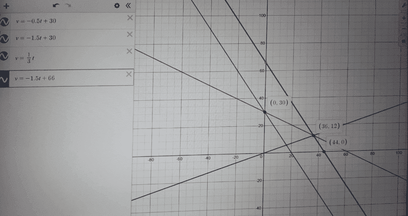

Ok, let me share my thoughts on this...as i explore further. Remember i came up with the idea of 'scale factor' to connect the two gradients...we have two gradients here and the latter one i.e a=##-1.5##, forms my point of reference. I assumed this gradient to come from the origin, which is the ##v=30##m/s, then having this line i was interested in finding the other parallel line that will intersect the other line with gradient, a=##-0.5## and this was made possible by the line ##v##=##\frac{1}{3}t## that was found using my so called 'scale factor'.
Of course i am not implying that this is correct, i just need more time to explore further by looking at my own created examples i.e if you have not done so...
This is how it looks like;
I take cognizant of your comments though and i really appreciate. Thanks mjc:cool:

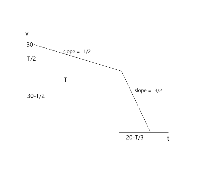

I drew this v-t plot. The area under the curve (rectangle + 2 triangles) is the distance covered (804 m). Express this as a function of T and solve for T.
nice...:smile:
##-2T^2+240T-6048=0##
##T=36## or ##T=84 (Unsuitable)##

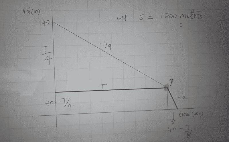

I managed to create my own problem on this and changed the values as indicated on my graph below; just to see whether the 'scale factor' may be an approach that can be adopted on such kind of problems.
note that i have my total distance as ##1200m##, initial velocity as ##40## and the acceleration values as ##-0.25## and ##-2## respectively, We are trying to find the time at the highlighted point just like what we did on our previous problem.
Now using mjc's approach in post ##13##, calculating this would give me
##\frac {1}{2}####[\frac {51200-320T-160T+T^2}{32}]##+##\frac {160T-T^2}{4}##+##\frac {T^2}{8}##=##1200##
##51200-320T-160T+T^2)+16(160T-T^2)+4T^2=76800##
##-11T^2+2080T+51200=76800##
##-11T^2+2080T-25600=0##
##T_1=13.233## and ##T_2##=##175.85##,

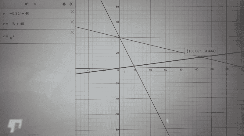

Now on using the scale factor approach, reference post ##1##,
i will intend to find the scale factor ##m##, where
##-2m##=##\frac {-1}{4}##
##m##=##\frac {1}{8}##
Now we have three set of equations to plot;
1. ##v=-0.25t+40##
2. ##v=-2t+40##
3. ##v##=##\frac {1}{8}####t##
The point of intersection of equation ##3## and equation ##1##, will give us the time that we are looking for. On plotting this we get;
Note that the value found is an approximate value with a difference of ##0.1## seconds from the exact value.
Again, it can only be coincidence, as you haven't used the total distance, and you get a unique answer where there are infinite possible answers depending on the value of the distance. For instance, if the total distance was 1000 m, there would be a different value of T, but your method would give the same as before.
True, I see your point...if $$s$$ would be a different value, then we may not have the same $$T$$ values. Thanks mjc...
