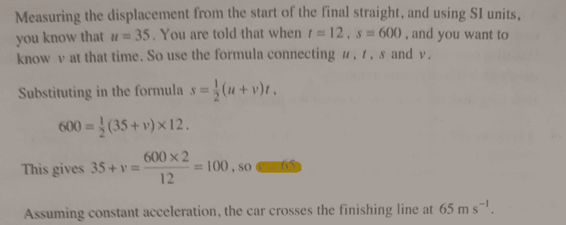

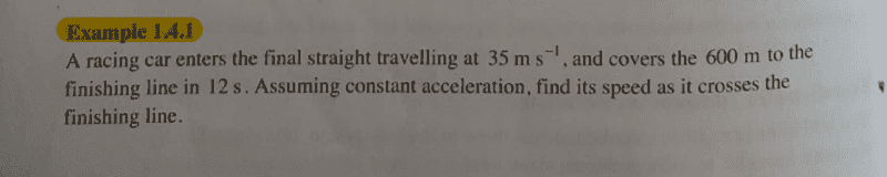

See attached ( reference is example 1.4.1)
##s=ut##
This is a textbook problem (Mechanics).
Attached find the question and respective solution.

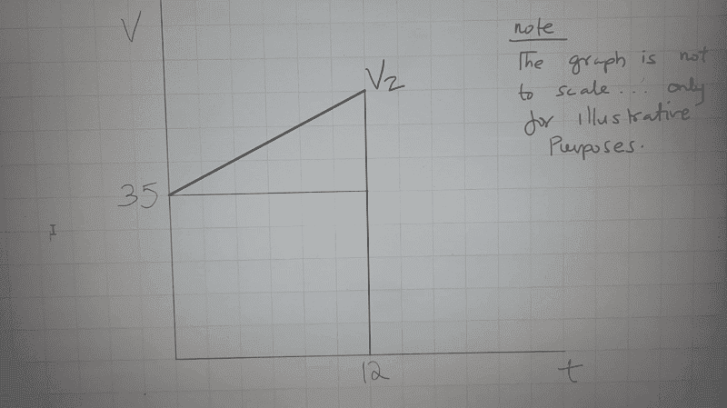

This is fine with me, i like trying different ways of solving math related problems. My approach is as shown below.
Using the graph sketch
It follows that,
##s##= ##(35×12)##+##\frac {1}{2}##×##12(v_2 -35)##
##600= 420+6(v_2-35)##
##600 = 420 + 6v_2-210##
##600 = 210 + 6v_2##
##390 = 6v_2##
→##v_2 = 65## m/s bingo
Any other approach will be appreciated...

You have of course noticed that you are solving the exact same equation...
For those of us for whom it is a sport to memorize a minimum of stuff, the ##s = {1\over 2} (u+v) t## requires derivation, which is work. Remembering ##s = v_0t+\frac 1 2 at^2 ## is somehow burnt into our brain and then it becomes a two step process:$$600 \ {\mathsf m} = 35*12 \ {\mathsf m} + \frac 1 2 at^2 \quad\Rightarrow\quad a = \frac {360} {144}$$ $$u = v_0 + at \quad\Rightarrow\quad u = 35 \ {\mathsf m/s} + \frac {360} {12} \ {\mathsf m/s} $$
And here we are ##-## of course ##-## solving the same equation, whether this is actually an other approach is a matter of taste...
