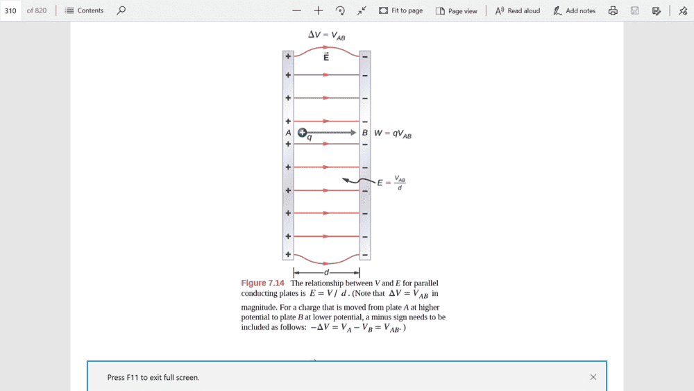

However, this just doesn't make any sense to me. Sorry if I'm being annoying but I don't want to just be satisfied getting the correct answer without seeing how it makes sense. This figure in my textbook is what is confusing me:
So, if these were the plates in my problem, then the voltage in the equation E = V/D would be the voltage from A (lets call this the zero volt plate) and b (the plate at 10 cm away from the other plate). However, that's not the voltage I am given in the problem. I am given the difference of 693v at a distance of 7.85 cm away from the zero volt plate. So this isn't the voltage from A to B, because the distance from A to B would be 10 cm, and this voltage is for a distance of 7.85 cm...So being able to use that distance and that given voltage in this equation seems like it shouldn't be correct.

This is a weird problem. But it is meant, I think, for you to realize that if the electric field is a constant then the ratio of the potential difference between any two points separated by the same distance between the plates is the same. So if you took two points separated by 2 cm for example anywhere between the plates the potential difference would be the same.
In your figure above if you draw straight lines between the plates and parallel to the plates equally spaced the potential difference between adjacent lines is the same i.e. constant.
Let me elaborate on what I posted before. Between the plates the potential function depends linearly on the distance from the reference plate. The slope of the straight line is the constant electric field. This means that anywhere between the plates we can write the potential function as a straight line:
$$V(x)=Ex+V_0$$
where ##V_0## is the value of the potential at ##x=0##. Here we are told that the potential is zero at plate 1. If we choose the origin of coordinates (##x=0##) to be also at plate 1, the equation simplifies to$$V(x)=Ex$$. If the value of the potential at a given point and the point are given, then you can easily find the slope ##E##. The plate separation is irrelevant.
