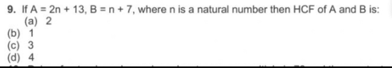

kindly see attached...
hcf
Kindly see attached:
Since n belongs to the class of Natural numbers, then we may have,
if ##n=1, hcf (A,B)= hcf(15,8)=1##
## n=2, hcf(17,9)=1##
##n=8, hcf (29,15)=1##...
Therefore in my reasoning the correct solution is b. Is there a different approach to answering this question?

Any sum or difference of A and B would also be divisible by their HCF. This gives the answer in two lines.

But that's just n=1. Try it for unknown n.
That was my first approach yesterday and i told myself that could not be the right approach, as they have indicated that we have to have ##n##, (its a condition )...i guess you want me to solve the simultaneous and eliminate ##n## from the picture.
and i am really not getting what you want me to do here, you are saying if i have two numbers say ##20## and ##25## being our ##A## and ##B##, then,
##25+20=45## clearly ##45## is divisible by the hcf value which is ##=5## in this case. Also,
##25-20 = 5## also divisible by the hcf value which is ##=5##...what exactly do you mean?
in our case, then ##A+B=3n+20##
##A-B=n+6##...then?

You tried A+B, which gave 3n+20. Try A-B instead.
The important fact, easy to prove, is that if c divides b and a then c divides a+b, a-b, a+2b, a-2b, 2a+b...

So what is the HCF of n+6 and n+7? If it still isn't clicking, take another difference to eliminate n.
The hcf is just equal to ##1##.

haruspex is using a version of the most important tool that exists for finding the HCF, called the euclidean algorithm. it is well worth learning. It occurs as Proposition 2, in Book VII of Euclid. In particular it works not just on this problem, but on essentially all such problems.
Howvever your method is also correct for this particular problem. Namely, if it is possible to find the HCF without knowing n, then the answer for any particular value of n must be the answer. Hence using just n=1 is sufficient. This also gives the answer in one or two lines, assuming the problem is correctly posed.

It’s a strange problem. I cannot tell what they are trying to teach. In my day they would have called this a new math problem. Maybe they wanted the OP to apply Euclid’s algorithm, but it does not look like the OP was taught that.

Yes, it ought to offer the option "not enough information".
