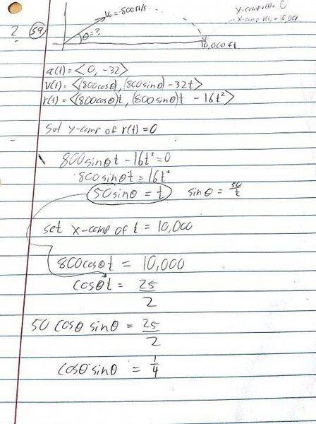

Find two elevation angles that will enable a shell, fired from
ground level with a muzzle speed of 800 ft/s, to hit a groundlevel
target 10,000 ft away.
Look at attached picture
***I get to cos(x)sin(x)=1/4, but I don't think you can solve that for an angle x...

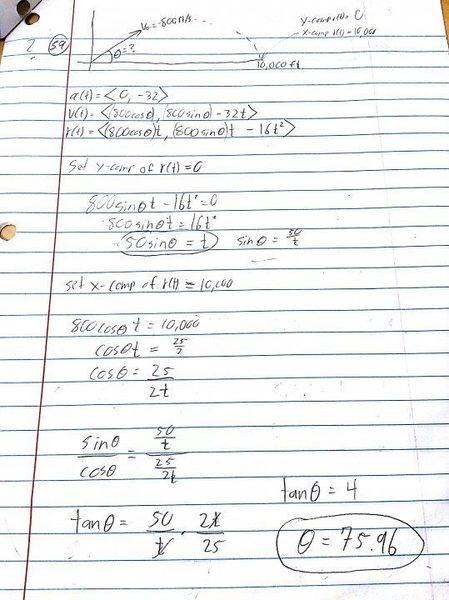

***UPDATE***
I got one of the angles, and it checks out with the answer key, but how on Earth do I get the angle of 15?
MY WORK:
ANSWER KEY:
Marcin H said:
***UPDATE***
MY WORK:
ANSWER KEY:
You have a mistake in your work. As best as I can tell, your answer is close only due to a coincidence.
One of your equations is ##50\sin(\theta) = t## and the other is ##800 \cos(\theta)t = 10000##
Your mistake is in solving for ##\sin(\theta)## in the first equation. It should be ##\sin(\theta) = \frac t {50}##.
BTW, please make an effort to post your work here, rather than as an image. Your work is somewhat difficult to read.
