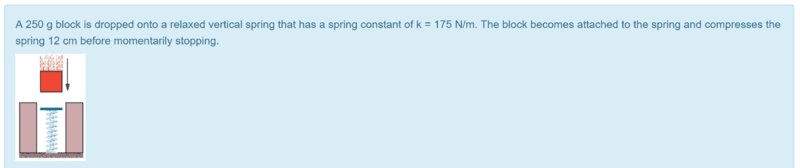

Find the initial speed of a block before it hits a spring
21 replies · 4K views
isukatphysics69
453

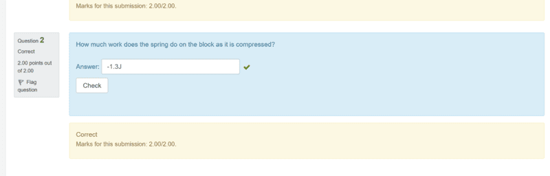

W =ΔKE
found work done by spring
-1.3 =ΔKE
-1.3 = KEFINAL - KEINITIAL
-1.3 = .5(0.25)(VFINAL2) - .5(0.25)(VINITIAL2)
Since v final is 0 since it stops momenteraly at the bottom of the spring
-1.3 = - .5(0.25)(VINITIAL2)
sqrt((-1.3/-.125)) = VINITIAL
VINITIAL = 3.22m/s

I assume you want to know why the answer to question 3 is incorrect.

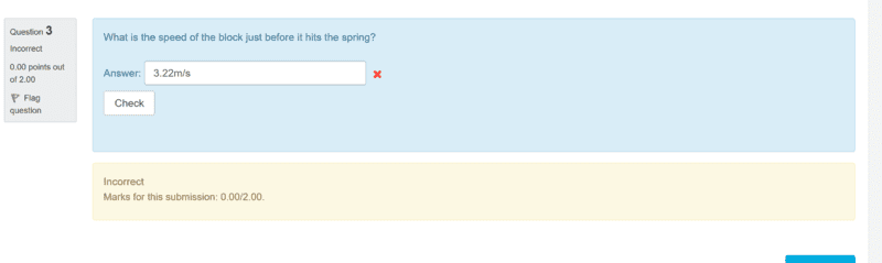

I see you have answered the work question with a precision of 2 significant digits. Then you used it to calculate speed at a precision of 3 significant digits.
I don't think that is the problem here, i think i am doing something wrong with the calculation logic here
-1.26 =ΔKE
-1.26 = KEFINAL - KEINITIAL
-1.26 = .5(0.25)(VFINAL2) - .5(0.25)(VINITIAL2)
-1.26 = - .5(0.25)(VINITIAL2)
sqrt((-1.26/-.125)) = VINITIAL
VINITIAL = 3.17m/susing the unrounded answer, still incorrect
So i was using the value of work for the spring on the block to find the initial velocity of the block, i am not sure if that is correct

i just tried 3.2m/s incorrect
I think we forgot about gravitational potential energy.
