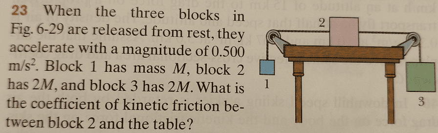

See image1.
Block 1: 1M kg
Block 2: 2M kg
Block 3: 2M kg
Resulting acceleration: .5 m/s2
F = ma
fk = Fn * u
Image1, the exercise.
My solution:
Image2, my solution
The answer is .37 but I keep getting .45
What am I doing wrong?

What's the total mass of the system?
5M but I don't see your point?
I use F=ma on the center block (block 2), what does the total mass have to do with anything?
All blocks will accelerate together, so their total mass is the total inertia.
Alternatively, assign unknowns to the tensions and draw a separate FBD for each block.
It produce the correct answer, but I still don't see the corelation.
I mean we only look at forces applied to Block 2, but for some reason we need to consider the mass of the two other blocks aswell?
I mean F (from F=ma) here is applied only to block 2, its not applied to block 1 or 3. If it were they'd all move sideways. How come m should include block1 and 3 then?
But did you? The forces on block 2 are the tensions in the strings. They are not equal to the weights of the masses suspended on the ends.
As I wrote, draw separate FBDs for each block, treating the tensions as unknowns.
