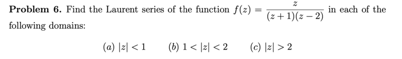

Problem 6 text: Find the Laurent series of f(z) = z / ((z + 1)(z - 2)) in each of the following domains: (a) |z| < 1, (b) 1 < |z| < 2, (c) |z| > 2.
(a)
i tried to decompose the fracion as a sum of fractions of form ##\frac{1}{1-g}##
$$f=\frac{-z}{(1+z)(2-z)}=\frac{a}{1+z}+\frac{b}{2-z}$$
$$a=\frac{1}{3}, b=-\frac{2}{3}$$
$$f=\frac{1}{6}\frac{1}{1+z}-\frac{1}{3}\frac{1}{1-\frac{z}{2}}$$
$$f=\frac{1}{6}\sum_{n=0}^\infty (-z)^n-\frac{1}{3}\sum_{n=0}^\infty(\frac{z}{2})^n $$
sory i posted too early
docnet said:
Homework Statement:: .
Relevant Equations:: .
(b)
$$f=-\frac{1}{3}\frac{1}{1-\frac{z}{2}}+\frac{1}{3z}\frac{1}{1+\frac{1}{z}} $$
$$f=-\frac{1}{3}\sum_{n=0}^\infty (\frac{z}{2})^n+\frac{1}{3z}\sum_{n=0}^\infty\frac{1}{(-z)^n}$$
then simplify...
(c) $$f=-\frac{2}{3z}\cdot \frac{1}{1-\frac{2}{z}}+\frac{1}{3z}\frac{1}{1+\frac{1}{z}}$$
$$f=-\frac{2}{3z}\sum_{n=0}^\infty (\frac{2}{z})^n+\frac{1}{3z}\sum_{n=0}^\infty\frac{1}{(-z)^n}$$
then simplify...aside from the need to simplify the expressions, is it a correct idea to re-write the fractions so the sum converges for each part of the problem?

A Laurent series is an expansion of f into a series of terms ##(z-a)## for some fixed a. They ask you for three series so you probably need to pick three different values of ##a##. Does that help?
Yes, you have the right idea.

For the function ##\frac{1}{1-z}##, you can have a Taylor series expanded at ##z_0=0## that converges for ##|z| \lt 1## and a Laurent series centered at ##z_0=0## that converges for ##|z| \gt 1## (since ##\frac{1}{1-z} = -a \frac{1}{1-a}##, where ##a=1/z)##. You can use this concept to combine appropriate series that converge in the regions specified in the problem.
  • Love
Just to complete the explanation:
You already can express the function as the sum of two simple ##\frac{c_1}{c_2-z}## terms.
Each of those can be expanded into a Taylor series that converges in a disk out to its singularity. Call these ##T_1## and ##T_2##.
Also, using the substitution ##a=1/z## in each term, gives a Taylor series in ##a## that converges for ##a## in a disk to its singularity. Substituting the ##1/z## back in for ##a## gives a Laurent series with all negative powers of ##z## that converges for ##z## beyond the singularity. (Note: ##singularity_z = 1/singularity_a##.) Call these ##L_1## and ##L_2##.
For the region of part a of the problem, ##T_1+T_2## is a Taylor series that converges.
For the region of part b of the problem, ##L_1+T_2## is a Laurent series that converges.
For the region of part c of the problem, ##L_1+L_2## is a Laurent series that converges.
