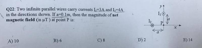

Find the magnetic field at a point
7 replies · 2K views · last reply
Fatima Hasan
315
Multiple-choice physics diagram: two infinite wires along the y-axis and x-axis, I1 = 3 A out of page at top, I2 = 4 A into page on the left, point P at distance a from each wire, answer options A) 10, B) 6, C) 8, D) 2, E) 14.
B=(μ0*I)/(2πr)
B2 = (4*4*10-7)/(2*0.1)
= 8 μT
B1 = (3*4*10-7)/(2*0.1)
= 6μT
Could I know how to determine the directions ?

Know about the right-hand rule ?
The directions matter (to some extent), but
do the signs matter ? They are only asking for a magnitude ...

So draw the arrows to find how you have to add them.
B2 = 8μT (-j) , because the direction of I2 is (-i).
B1 = 6μT (i) , because the direction of I1 is (j)
So , Bnet = √(82+62) = 10 μT ?
I'd vote for ##-\hat k## :rolleyes:
So , B2 (##-\hat j##)
B1 (##\hat i##)
I agree. (I also agreed with #5, except for the directions of the currents :wink:)
I hope you now understand my frivolous 'do the signs matter': in this case just knowing that the field vectors are perpendicular is enough to get 10 ##\mu##T as answer. Normally the signs certainly do matter.
