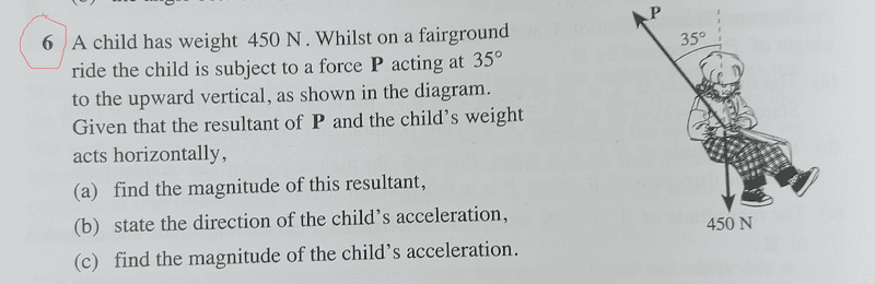

see attached [ Question 6]
Mechanics

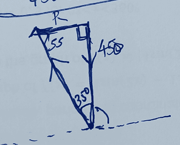

In my working i have;
For a)
##\tan 55^{\circ} = \dfrac{450}{R}##
##R = \dfrac{450}{\tan 55^{\circ} }= 315 N##
part b) no problem here ...horizontal to left.
c) This is where my real doubt is,
i have using sine rule;
##\dfrac{9.8}{sin 55^{\circ} }= \dfrac{a}{sin 35^{\circ}}##
##a = \dfrac{9.81 \sin 35^{\circ}}{\sin 55^{\circ}} = 6.86 ## m/s
There could be an alternative approach.
Sure, that works, but you could just as well apply the equation for the tangent that you used in (a):
a = g/\tan 55^\circ
Note that
\tan 55^\circ = \sin 55^\circ / \cos 55^\circ
= \sin 55^\circ / \sin(90^\circ - 55^\circ)
\sin 55^\circ / \sin 35^\circ
so the result is obviously the same as what you got

The alternative approach may be to use Newton's second law. You know the net force, don't you?
Correct, I have;
##F = ma##
##315 = \dfrac{450}{9.8} a##
##315 = 45.9a##
##a=\dfrac{315}{45.9} = 6.86 m/s##
The confusion on this question was on the value assigned to gravitational force. Its confusing as to whether to use ##10 m/s^2## or ##9.81 m/s^2##.
Cheers man!
chwala said:
##a=\dfrac{315}{45.9} = 6.86 m/s^2##
Why is the problem stating that the weight of the child acts horizontally?
It ... is not ...
Given that the resultant of P and the child's weight acts horizontally.
My emphasis.
This is necessary to make the problem solvable. Other types of rides, such as a simple back and forth swing, would have a different direction resultant.
