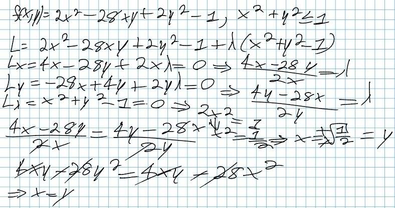

f(x,y) = 2x^2 - 28xy + 2y^2 - 1 on the disk x^2 + y^2 <= 1.
(a) Find the maximum.
(b) Find the minimum.
Lagrange Multiplier method and partial differentiation.
My work is attached as MyWork.jpg. If anything is unclear, tell me and I will restate it (or whatever it is you request). In the image, I forgot to plug in x and y in f(x,y) to get f(sqrt(1/2), sqrt(1/2). This yields the correct answer for the minimum: 2*(sqrt(1/2))^2 - 28*sqrt(1/2)*sqrt(1/2) + 2(sqrt(1/2))^2 - 1 whereas the correct answer for the maximum is: 2*(sqrt(1/2))^2 + 28*sqrt(1/2)*sqrt(1/2) + 2(sqrt(1/2))^2 - 1. So, my ultimate question is, what are the reasons for choosing positive or negative square roots for x and/or y?

In the problem max f(x) s.t. g(x) <= 0, if you want the Max you should use L = f - λg, with λ ≥ 0; if you want the Min you should use L = f + λg, with λ >= 0 (or use f - λg with λ ≤ 0).
How can you remember this? The easiest way is to form L so that it is more favourable than f for feasible points; that is, for feasible points, L should be ≥ f in a max problem and should be ≤ f in a min problem. So, if the constraint is g ≤ 0 we get something ≥ f in a max problem by subtracting g, that is, by using L = f - λg with λ ≥ 0.
Note that for an equality constrained problem, with constraint g = 0, the sign of λ is not determined, and it does not matter whether you write L = f + λg or L = f - λg.
So, in your analysis you need to look at the sign of your λ.
RGV
The Lagrange multiplier method requires that you have "=" in the constraint. You can use that to determine any max or min on the boundary. Just set the partial derivatives equal to 0 in the interior of the disc.
