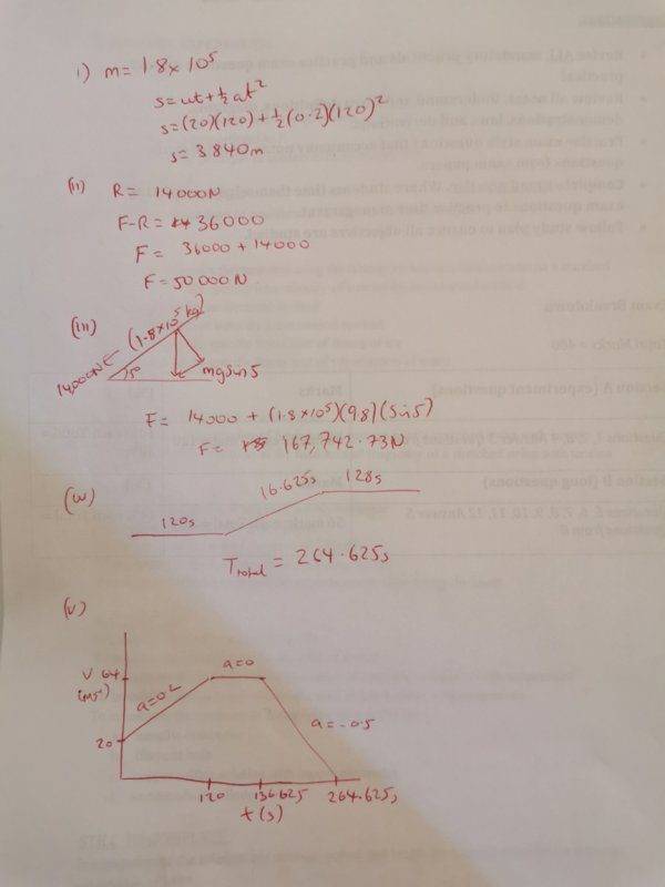

Tayto8 Messages 1 Reaction score 0 Thread starter Mar 3, 2020 #1 New poster has been reminded to type their work into the forum instead of posting pictures of their work Homework Statement I've completed it but I don't think it's right could someone please check? Relevant Equations Equations of motion See question and attempt answer below. Thanks. Attachments IMG_20200216_191429.jpg 102.7 KB · Views: 175 15832435152655068997620523086430.jpg 27.5 KB · Views: 183
CWatters Science Advisor Homework Helper Gold Member Messages 10,546 Reaction score 2,324 Mar 3, 2020 #2 i), ii) and iii) I agree with your answers. However check your calculation for the velocity after the initial 2 min acceleration... V=U+at U=20 m/s a=0.2 m/s/s t=120 s (2min) = 20 + (0.2*120) = 20 + 24 = 44m/s eg not 64m/s I think you double counted the initial 20m/s. That effects the stopping time and distance and the time at constant velocity.
Lnewqban Homework Helper Gold Member Messages 4,201 Reaction score 2,394 Mar 4, 2020 #3 As explained above, answer iv) and graph are not correct because the calculated value of speed for end of acceleration period/beginning of slope is too high. For same reason, calculated times values are not correct.
