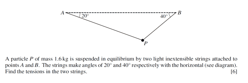

Find the tension in the two strings
  • Thread starter Thread starter chwala
    Strings Tension
7 replies · 3K views · last reply
chwala
2,854
436
See attached;
Mechanics
This is an exam question - refreshing as usual.
Diagram of a particle P suspended by two strings from points A and B, which lie on a horizontal dashed line; the string to A makes 20° with the horizontal and the string to B makes 40° with it. Below is the printed exam question about finding the tensions.
Literature Overview;
In the free-body diagram shown above, we can see the horizontal and vertical components of the tension forces, T₁, and T₂. Forces are vectors, which means they always have both magnitudes and directions. Like all vectors, forces can be expressed in these components, which give the force's influence along the horizontal and vertical axes. T₁ₓ and T₂ₓ are the horizontal components of T₁ and T₂, respectively. On the other hand, T1y and T2y are the vertical components of the same forces, respectively. Since gravity acts on the object in the vertical axis, we need to consider the tension forces' vertical components for our summation of forces as follows:
##ΣF↑ = 0 = T_1 y + T_2 y + (-W)##
##T=W## where ##T=T_1 y + T_2 y##
##16 = T_1 \sin 40^0 + T_2 \sin 20^0##
We can also say that for the system to be in equilibrium, the object should not move horizontally or along the x-axis. Therefore, the horizontal components of T₁ and T₂ must then equate to zero. Also, with the help of trigonometry, we can express T₁ₓ and T₂ₓ in terms of T₁ and T₂, respectively:

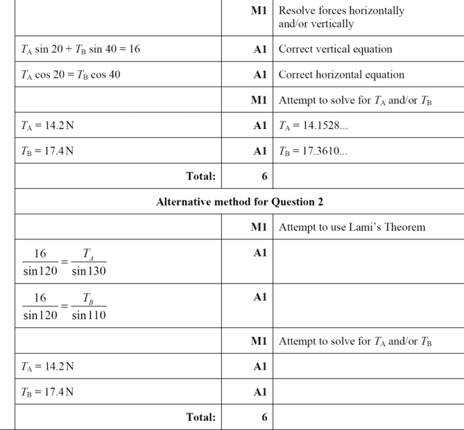

Find mark scheme solution here;
Marking scheme table for a tension problem listing M1 and A1 marks: resolving forces, vertical equation T_A sin 20 + T_B sin 40 = 16, horizontal equation T_A cos 20 = T_B cos 40, giving T_A = 14.2 N and T_B = 17.4 N, plus an alternative method using Lami's Theorem.
The diagram shown is not a free body diagram.
The long explanation is unnecessary. Look at the mark scheeme - there are no marks associated with the explanation. In an examination, this would cost you valuable time for zero benefit.
This is irrelevant. The question tells you that the object is in equlibrium. (In any case, an object can be moving and still be in equlibrium - providing its velocity is constant.)
You don't need to say all that.
chwala said:
##T_1 x = T_2 x##
To be consistent with your approach to the vertical components, you should write
##T_1 x + T_2 x = 0##
chwala said:
##T_2 = 14.153## to 3 decimal places.
##T_1=\dfrac{14.153 ×\cos 20^0}{\cos 40^0}=17.361## to three decimal places.
If these are intended as final answers, you have forgotten the units and 3 decimal places is unjustifiable.
Your understanding is good but (IM O) you should make your answers far more concise.
And note that Lami's method is much simpler!

I would clarify in the solution that the units of weight and tensions are Newtons.
The hanging mass of 1.6 kg becomes 16 N in the initial equation without showing the mg step.
Yes, that's pretty straightforward; we use ##w=mg##. Where ##g=10## m/s^2.
