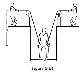

A man has fallen into a ditch of width d and two of his friends are slowly pulling him out using a light rope and two fixed pulleys as shown in figure. Show that the force (assumed equal for both the friends) exerted by each friend on the road increases as the man moves up. Find the force when the man is at a depth h.

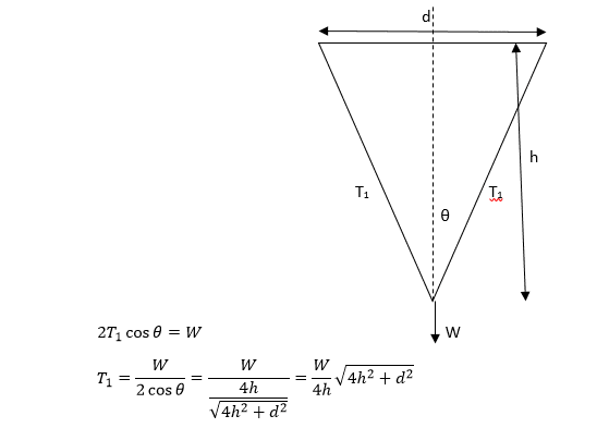

The diagram represents one half of the system.
##W## is the weight of the man.
##T_1 cos \theta = T_2## --> The horizontal component of ##T_1 = T_2## right ?
##T_1 cos \theta = T_1 \frac {d}{\sqrt {4h^2 + d^2}} = T_2##
##T_1 sin \theta = \frac {W}{2}##
##T_1 = \frac {W}{2 sin \theta}##
##T_2 = \frac {W}{2 sin \theta} \frac {d}{\sqrt {4h^2 + d^2}}##
By taking ##sin \theta## as ##\frac {2h}{\sqrt{4h^2 + d^2}}##
##T_2 = \frac{Wd}{4h}##
By taking ##T_1 = \frac {T_2}{cos \theta}##
We get ##T_1 = \frac {W \sqrt{4h^2 + d^2}}{4h}##
But ##T_1## and ##T_2## are supposed to be the same right ?

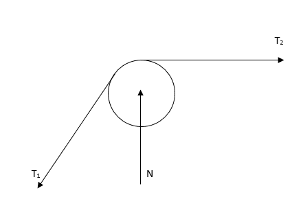

The free body diagram of one pulley should look like above, the other one will be a mirror image.
The tension ## T_2 ## is created by the man's friends pulling the rope.
## T_1 ## has a vertical and a horizontal component. The vertical component (downwards) is balanced by the normal reaction of the pulley (upwards). The horizontal component is balanced by ## T_2 ## right ?
No. You are assuming there is no horizontal component to the support force on the pulley, and as a result deducing that the tensions are unequal. Since we know the tensions must be equal (consider torque balance on the pulley), your assumption must be wrong.

You can read the approximate direction in which the support force on the pulley must point by looking carefully at the diagram.
The two tensions form an angle. The angle bisector (pointed up and to the left) is the direction the net force from the pulley on the cord must point.

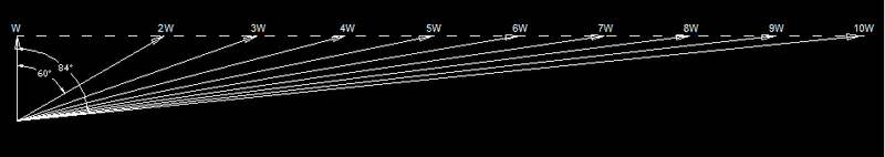

The attached diagram has been drawn at scale and shows how the tension in the rope increases as the load (which weight has been represented as W) is moved up.
Note that when the rope adopts an angle of 60° respect to vertical, the value of the tension becomes 2W.
Just 14° more, when the rope adopts an angle of 84° respect to vertical, the value of the tension becomes 10W.
As the angle tends to 90°, the tension tends to infinite.
