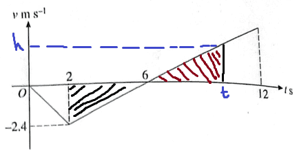

In my head I did:
3 triangles, 0-2, 2-6, 6-t.
Need first two areas to add up to the third.
First area is half of second (same height, half the base).
So third is 1.5 times area of second.
Similar triangles, so ratio of areas is square of ratio of sides.
t=6+(6-2)√1.5

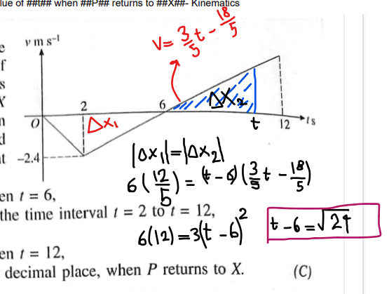

Another way without integrals :
I can see that you have used similarity, if i am correct with height for Δ##x_1##= ##(2.4-0) = \dfrac {12}{5}##
I just want to get this clear you're implying that,
##\dfrac{6}{t-6} = \left[\dfrac{\left(\dfrac{3t-18}{5}\right)}{\left(\dfrac{12}{5}\right)}\right]##
Yes. We have two triangles. One from ##0## to ##6## and one from ##6## to ##t>6##. Area of these two triangles should be the same. You know that the area between ##v(t)## curve and ##t## axis is displacement. For ##v<0## the displacement is negative and for ##v>0## the displacement is positive. So magnitude of displacement from ##0## to ##6## should be equal to magnitude of displacement from ##6## to ##t##. (Magnitude of displacement = Area of triangle.) This way the total displacement by the time ##t## would be zero.
First triangle :$$A_1 = (\frac 1 2)(6)(\frac {12} 5)=\frac {36} {5}$$
Second triangle :$$A_2 = (\frac 1 2)(t-6)(\frac {3} {5} (t-6))=\frac 3 {10} (t-6)^2$$
We should have ##A_1=A_2## so : $$(t-6)^2 = 24$$$$t=6+\sqrt {24}$$And ##t>6## implies that ##t=6-\sqrt {24}## is not acceptable.
Edit : You've used similarity in a wrong way.
To find height ##h## you write similarity equation for these two ...
