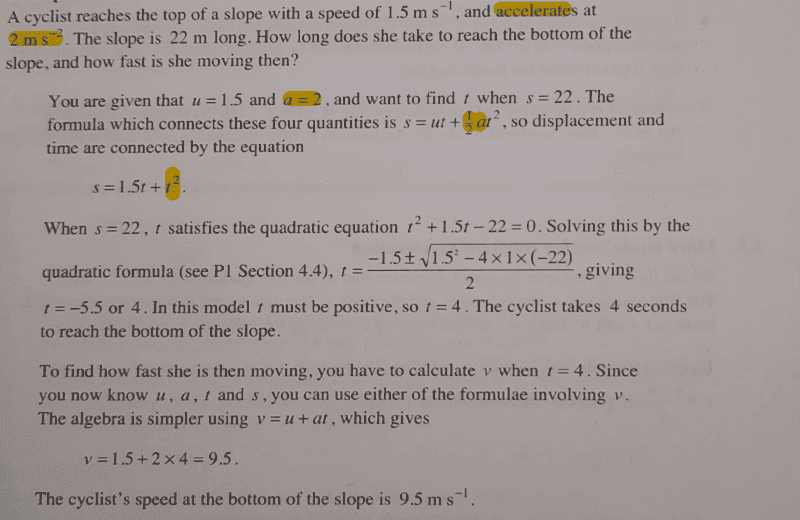

Kindly see attached
##s##=##ut##+##\frac {1}{2}####at^2##
Now this is a textbook example with solution.
I understand working to solution...my only reservation is on how they used acceleration. The cyclist, i understand was traveling at a constant acceleration of ##2## ##m/s^2## before reaching the top part of the slope.
Now, if he is descending, which outrightly is deceleration or rather retardation, then are we assuming that he is traveling at the same constant rate of acceleration?
ok, i think i get it now...When going down the slope we are now going to have our initial velocity being ##u=1.5####m/s##...
i had to imagine/visualize a cyclist in motion going up a slope then change of direction to negative slope (still in motion)...then it is clear that the initial velocity will be ##1.5##m/s^2##...cheers guys... :smile:
That's not how I read it. I interpreted it to mean that the cyclist's acceleration is 2 m/s2 starting at the top. However, this is irrelevant because the position and speed at the top are both known, so it doesn't matter what happened before.
Why deceleration? The cyclist is going faster going down the hill, which is usually what happens! The speed is to be considered here with respect to the ground, not along two Cartesian coordinates.
i had to imagine/visualize a cyclist in motion going up a slope then change of direction to negative slope (still in motion)...then it is clear that the initial acceleration will be ##2####m/s^2##...cheers guys... :smile:
See above.
DrClaude said:
That's not how I read it. I interpreted it to mean that the cyclist's acceleration is 2 m/s2 starting at the top. However, this is irrelevant because the position and speed at the top are both known, so it doesn't matter what happened before.Why deceleration? The cyclist is going faster going down the hill, which is usually what happens! The speed is to be considered here with respect to the ground, not along two Cartesian coordinates.See above.
Thanks. Noted with regards...
