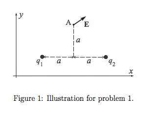

Find the unknown charges q1 and q2
JessieS
The geometrical positions of point-like charges and point A situated in the xy-plane in terms of the length parameter a. The vector of electric field E at point A is shown schematically and measured as E = Exi + Eyj (that is, both Ex and Ey are given). If possible, find the unknown charges q1 and q2.
**E_2 is the electric field with respect to q2. Not shown in figure. **
**E_1 is the electric field with respect to q1. (Same direction as E) **
**k_e is Coulomb's constant.**
E[/B] = Exi + Eyj
Ex = E_1*cos(45°) - E_2*cos(45°)
Ey = E_1*sin(45°) + E_2*sin(45°)
E = F/q = (k_e*q)/r^2
E_1 [/B]= (k_e*q1)/(2a)^2 = (k_e*q1)/(4a^2)
E_2 = (k_e*q2)/(2a)^2 = (k_e*q2)/(4a^2)
Ex = (E_1 - E_2)*2/sqrt(2)
Ey = (E_1 + E_2)*2/sqrt(2)
E
= 2/sqrt(2)*(E_1 - E_2) i + 2/sqrt(2)*(E_1 + E_2) j = 2/sqrt(2)*(k_e/(4a^2))*(q1 - q2) i + 2/sqrt(2)*(k_e/(4a^2))*(q1 + q2)I am stuck here; I'm not sure if I've been going about this correctly or what steps to take next.
Thank you.

Hello JessieS , Welcome to PF !
Are you given any numerical values, particularly any for Ex and Ey ?
Thank you!
And no I am not. I am supposed to just use Ex and Ey as variables.
JessieS said:
Thank you!
OK.
You are on the right track.
First, at least one error. What is the distance from q1 to A and q2 to A. The square of each of those distances is 2a2, not 4a2 .
I suggest that you keep Ex and Ey separate, rather than lumping them together into one big vector expression.
You have that Ex = C⋅(q1 - q2) and Ey = C⋅(q1 + q2) , where the coefficient, C is made up of all that stuff in your equation.

Ok, so could I do this?
Since
Ex = 2/√2*(q1 - q2)*(ke/(2a2))
Ey = 2/√2*(q1 + q2)*(ke/(2a2))
Then
(q1 - q2) = (Ex * a2*√2)/ke
+ (q1 + q2) = (Ey * a2*√2)/ke
q1 = (a2*√2)/ke * (Ex + Ey)
So then
q2 = (a2*√2)/ke * (Ey - Ex)
Is that correct?

Yes. That's it.
Subtracting should give q2.
