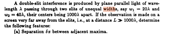

Hello. I am having some trouble to understand the resolution of this question.
We could easily try to calculate the electric field relative resultant at the screen. The problem i am having is about the amplitude of the electric field:

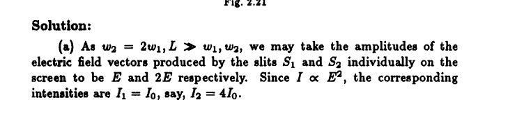

Generally, we have that the intensity part dependent of the width of the slits is $$I = C(\frac{sin \beta}{\beta})^2$$, where ##\beta = \pi w_i \theta / 2##, so that ##|E| = C' \sqrt{I} = C'' / w_i##, that is, the ampltitude of E is inverselly proportional to w. This would imply that the ##w_2## slit produce a electric field with amplitude weaker than the other one, in fact, $$|E_1|/|E_2|= 2$$.
BUT, the solution says that ##|E_2|/|E_1| = 2##, so where am i wrong?

Actually, it has something with the question yes. After all, to calculate the relativies intesity at the screen, you will need to calculate the resultand electric field at each point of the screen, and so it is of great importante to know what will be the amplitude of the eletric field of the diffracted wave at each of the slits. SInce after find the eletric field amplitude the solution becomes trivial, the main problem here is to find the amplitude itself.
But, for while i can't see an error on my idea. Even so, the solution provides a diferent answer, and so probably mine is wrong. Since you are knowing better than me why my idea is wrong, i think you could give me a tip of how to deduce the relativity electric field amplitudes after diffract in each slits? Maybe if i understand your argument of how to find the amplitudes, i can see where is the error on mine approach.
Q1 , ##I = \frac {C}{\omega^2}##, in Post #3, is wrong. Do you understand why?
Q2. Do you undertsand how to find δx (the spacing between maxima) for 2 slits of equal widths? (No electric fields or intensities are needed - it's a geometry problem.)

The question given here talks about interference phenomenon.
According to me, the Intensity formula that you have stated is regarding the diffraction phenomenon.
For interference, the wider the slit is, the individual electric field produced will be more. Qualitatively, looking at the values, since the width has doubled, and therefore the amplitude of electric field doubles, and as Intensity is proportional to the square of the electric field, you will get the answer. Finding the individual and resultant fields at a point can be done through geometry using second order approximations.
