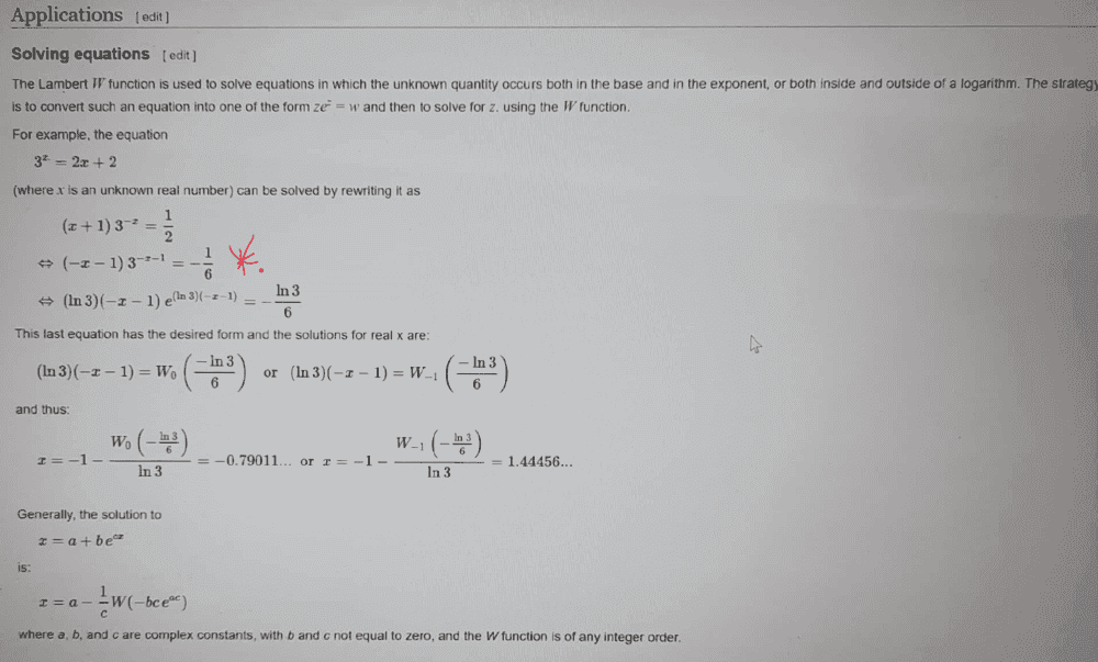

I got this problem from wikipedia, the problem is on the attachment.
Solve the equation ##3^x=2x+2## using the Lambert W function.
Lambert W function
it really took me time to figure out as to how that equation in aterisk was arrived at...i just noted that both sides of the equation were multiplied by ##-\frac {1}{3}## any particular reason for that? what is the common thinking around that? can one multiply both sides by say ##\frac {1}{6}##? i am encountering this lambert for the first time and i really want to understand how it works...i would appreciate guidance leading to solution. Can one use the ti nspire to find the Lambert W value, in reference to the very last step leading to ##-0.79011## and ##1.44456##?

Have you checked your results with WolframAlpha? They say it's ##x=-\dfrac{1}{\log 3}\left(W_n\left(-\dfrac{\log 3}{6}\right)+\log 3\right)##.

Post #2 looks good. But you made a mistake: it isn't ##e^{-2-x}\ln 3##. It has to be ##e^{(-2-x)\ln 3}## which makes the rest going wrong.

Sure. But you will get a multiple of ##x## so you will probably need a ##w=ax+b## substitution of so.
I am really not getting what you are saying. Look at the original post ##1##. My post ##2## and ##3## is simply an exact repetition of post ##1##. I wanted to know if ##3## is correct as I used a different factor ...What i simply wanted to know is how the author arrived at the solutions of ##-0.79## and ##1.44## that is the only part I would like to understand.
Post ##5## is my own created problem,...I was simply trying to follow post ##1## in order to solve it. I hope this is clear, I just made some typo errors but my working is correct.

Sorry, I ignored the picture in post #1, because I thought it is from a book and I normally ignore any photos, because they are hard to read and my eyesight isn't what it was anymore.
Yes, these seem to be correct. WolframAlpha only confirmed the ##W_1## solution, so I could only take the graph to check the ##W_0## solution, but it looks o.k.
