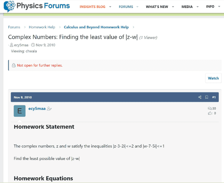

Bvu:smile:...you can tell from my working that i know how the pic looks like:cool:...This is the 2010 post;
Haha, as if I care for a screen shot. My angle was: if you refer to something, don't let others search for it but provide a link. @SammyS understood.
Same difference: yes I can, but maybe others can not.
