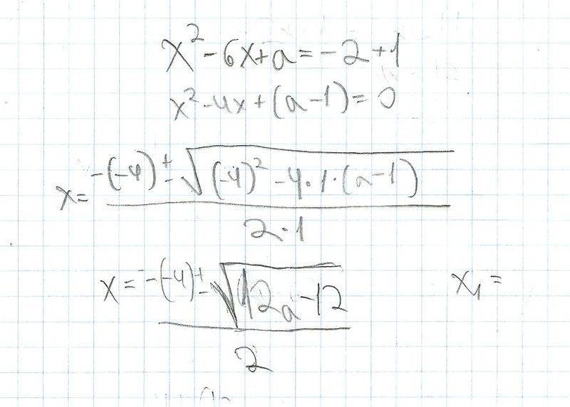

I kinda get stuck here, unsure how to take a square root of a number with an unknown
That's right, you cannot take the square root of a number with an unknown.
The "trick" is that you know something else: there must be only 1 solution.
Try it for instance with a = 0 and also with a = 2.
Which (and in particular: how many) solutions do you get?
[edit]btw, I just saw that your calculation that came out to (12a - 12) is not quite right.
I guess we can get to that in a minute.[/edit]
I plug (-4)2-4 * 1 and I get 12
So from there it's 12(a-1) = 12a -12
That's for the numerator under the square root
There's a rule that multiplying comes before adding/subtracting.
So (-4)2 - 4 * 1 * (a - 1) = (-4)2 - (4 * 1 * (a - 1))
(Notice that I've added a couple of parentheses to emphasize the order of evaluation.)
This comes out to:
16 - (4 * (a - 1))
Since you have an unknown, you can't calculate e.g. (a - 1) yet, but what you can do is rewrite the expression, eliminating the parentheses.
That is:
16 - (4 * a - 4 * 1) = 16 - (4a - 4)
[edit]That is because:
2 * (3 + 4) = (2 * 3) + (2 * 4)
Try it if you don't believe me! :)
[/edit]

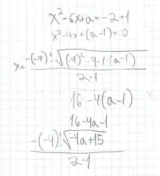

Femme_physics you should revise your algebra!
*smacks forehead* It's the calculator's fault! I mean, the way I tried to solve it using a calculator instead of writing everything down.
I'll try it again then. Thanks :)
So, there it is. I'm still getting stuck with the same concept that I can't take the square root of an unknown.
I'm going to take this one step at a time.
You write:
16 - 4(a - 1)
and then you make from this:
16 - 4a - 1
This is not right.
If you for instance fill in "a = 2", you'll get:
16 - 4(2 - 1) = 16 - 4(1) = 12
respectively:
16 - 4 x 2 - 1 = 16 - 8 - 1 = 7
You need to find something that if you fill in a value for "a" the results before and after match.

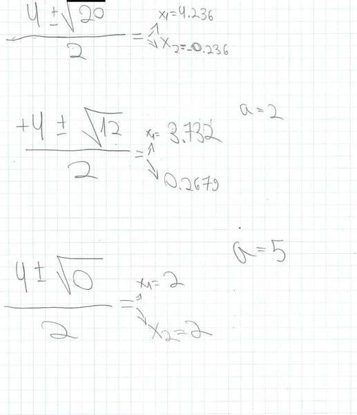

Okay, I gave it a shot, and after three random guesses it appears that a=5, where the whole shebang under the square root goes to zero, that gives the same 2 results.
So I'm always supposed to get the whole shebang under the square root to get to 0 to find a?
:smile:
Only if you want the equation to have exactly 1 solution, which now we do.
It's a kind of special case in which you can solve 2 unknowns from 1 equation, but only with the extra information that the parabola "touches" the line.
Woahhhhh...I'm on math drug... :cool:
Many, many thanks for getting me there ILS!

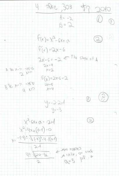

Earlier, you wrote this.
Femme_physics said:
Yes-- but I don't have "a", "a" is a parameter.
I was able to solve it only using calculus.
Did you get the same values for x and a (using calculus)?
Well, I just needed to find a, not x! I'm not sure what you mean :confused:

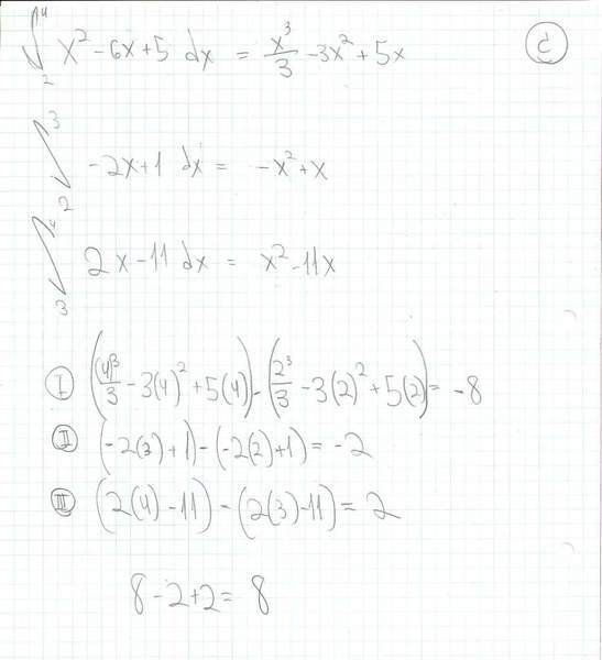

By the way, now it's really getting into calculus, for the last question I need to find the area that's caged above the slopes but below the function (graphed in the original upload).
I persume I take the integral of the parabola's function from 2 to 4, then reduce it by the integrals of the two slopes from 2 to 4. Does it make sense?
The problem statement asks for the coordinates of A and B.
You have just not only found a = 5, but also x = 2 for point A.
You're not entirely finished yet, because you also need the y-coordinate of A, and the coordinates of B.

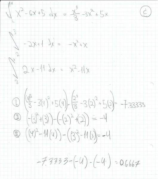

Yes, that makes perfect sense! :smile:
Take note however that you need to take the integral of the first slope from 2 to 3, and the integral of the second slope from 3 to 4.
