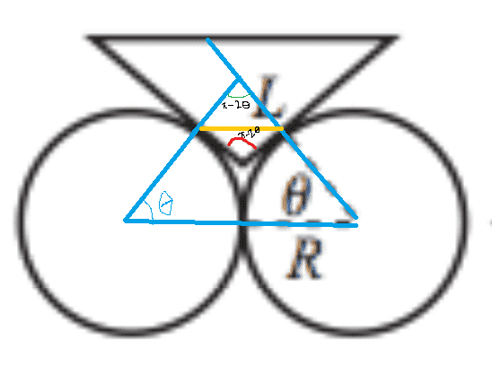

I am trying to find the following (marked in red) angle, I know that the radii to the points of contact make an angle θ with the horizontal.
all angles of a triangle add up to 180 degrees.
isosceles triangle, has two equivalent sides
I tried using symmetry and found the part in red is [itex]\pi[/itex] - 2[itex]\theta[/itex]
but according to the text, the angle is 2[itex]\theta[/itex]. I am confused on why is is 2[itex]\theta[/itex]
The sides of the inverted triangle are tangents to each circle.
The base of your blue triangle is 2R.
The angles on either side of the base must be ##\theta##.
The blue-triangle apex angle must be ##\pi-2\theta## ... which is where you've got up to.
The apex of the blue triangle forms a diamond shape with the inverted triangle.
The bottom of the diamond is the angle you want.
The left-hand angle is the same as the right-hand angle - you actually know what these angles are!
What do the angles in the diamond add up to?
