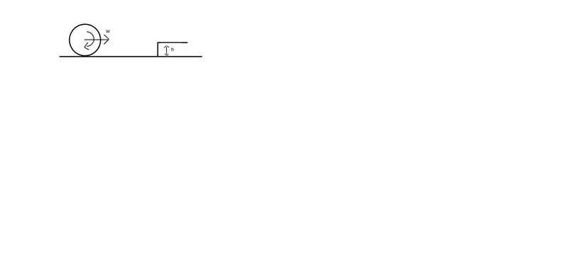

A solid uniform sphere of radius R and mass M rolls without slipping with angular velocity (w) when it
encounters a step of height 0.4R . find the angular velocity immediately after inelastic impact with the rough step.
By conserving angular momentum about the contact point with the rough step -
MwR(R-h) + Iw = Iw'
But the answer is coming wrong . Its answer is 5w/7

MwR(R-h) + Iw = Iw'
Mw0.6(R^2) + 0.4Mw(R^2) = 0.4M(R^2)w'
w'= 5w/2
Please tell the mistake
Need a little bit more help
what is the value of moment of inertia and it is about which axis ?
you need the angular momentum, L, about the corner of the step …
in other words, about a point (O) on the surface of the sphere
since this isn't the centre of mass (C), there are two ways to calculate it …
i] (this works for any point) L = ICω + m*OC x vc.o.m
ii] (this works only for the centre of rotation) L = IOω
(they work out the same because IO = IC + mOC2 … the parallel axis theorem)​

I have a question, not very familiar with rotational problems. Angular momentum before impact is angular momentum of the rotation plus the angular momentum from moving of the center of mass. How does the formula MwR(R-h) give it to me?

chingel said:
… plus the angular momentum from moving of the center of mass. How does the formula MwR(R-h) give it to me?
Mωr is the momentum (Mvc.o.m), and R-h is the perpendicular distance from the point to the line of the velocity of the c.o.m.

I'm having trouble understanding what does the MwR(R-h) give? Is it r x mv and how does it give that?
yes, r x mv
ωR is the initial speed, v
so MωR is the initial momentum, mv
then you need the distance, r, by which the initial momentum "misses" the pivot point (the corner of the step) …
the initial momentum goes through the centre of mass, and it's horizontal, so it misses the step by a vertical distance, r = R-h :wink:
Ah, I see. The angular momentum is considered at the time when the center of mass would be just over the contact point with the step. Even though this is not possible, the angular momentum stays the same no matter during which time we consider it, since there is no torque. At that point, the velocity and radius are perpendicular, enabling an easy calculation. Do I understand it correctly?
chingel said:
… At that point, the velocity and radius are perpendicular, enabling an easy calculation. Do I understand it correctly?
i think so
if you use the perpendicular distance, the calculation is easy, because the sin is 1
if you use the actual distance to the centre of mass (or any other point on the line), you have to multiply by the sin of the angle
