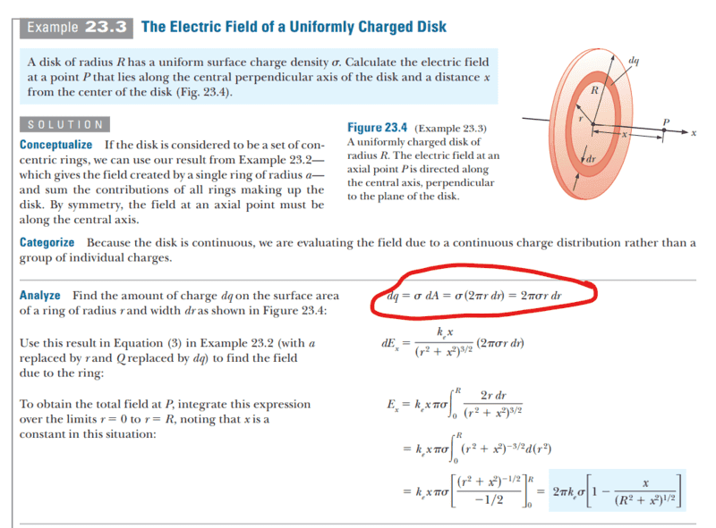

A disk of radius R has a uniform surface charge density s. Calculate the electric field at a point P that lies along the central perpendicular axis of the disk and a distance x from the center of the disk
Continuous charge distribution formula
Hi!
For this problem,

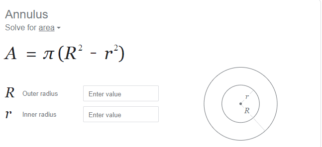

Why is the area of each ring segment dA equal to (2π)(r)(dr)?
However, according to google the area of a ring segment (Annulus) is,
Many thanks!
Cut the thin ring and stretch it out. You get a rectangular strip of length ##2\pi r## and width ##dr##. What is its area?
The area of the annulus is indeed what google says. Note that
##R^2-r^2=(R+r)(R-r)##
For a thin ring ##R## and ##r## are very close to each other so that ##R-r=dr##. You can then approximate ##R+r\approx 2r## so that ##R^2-r^2\approx 2rdr##.

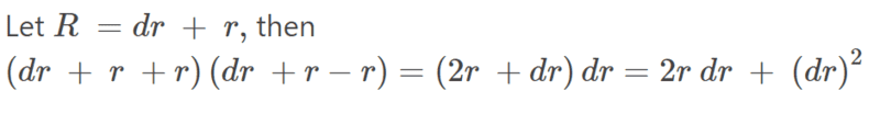

Thank you, I have written up and realized I had a new question:
What if we choose not to approximate? How would we integrate the infinitesimal (dr)^2 term?

Well, you will notice that if you integrate
$$\int dA = 2\pi \int_{r}^{R} r~dr $$
That it is exactly:
$$ A = \pi \left( R^2 - r^2 \right)$$
So the term ##(dr)^2## is not contributing anything. In the limit as ##dr \to 0 , 2 r ~dr ## is exact.

I don't believe you ever would. It doesn't follow from the definition of the derivative.
$$ (A + \Delta A)- A = \pi \left[ \left( r + \Delta r \right)^2 - r^2\right] \implies \Delta A = \pi \left[ 2 r ~\Delta r + (\Delta r)^2 \right] $$
The derivative is given by:
$$ \frac{dA}{dr} = \lim_{ \Delta r \to 0 } \frac{\Delta A}{ \Delta r} = \lim_{ \Delta r \to 0 } \frac{ \pi \left[ 2 r ~\Delta r + (\Delta r)^2 \right] }{ \Delta r} = \lim_{ \Delta r \to 0 } \pi [ 2r + \cancel{ (\Delta r)}^0 ] = 2 \pi r $$
So if there are any first order ( or higher ) ##\Delta r ## terms left hanging around they vanish in the limit.
