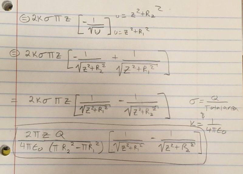

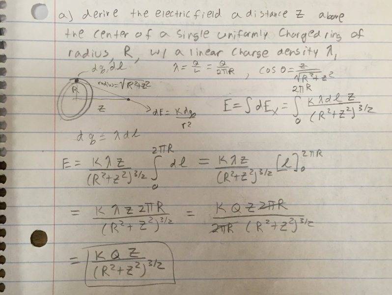

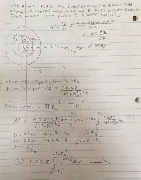

My attempts are attached. The attachment labeled A, is part A. Part B took a lot of paper so there are two attachments labeled B1 and B2. It is really B and C that I am struggling with. Not sure if I am on the right track or if it is correct. Any help would be much appreciated!
A little more thought: All the problems I have done in the back of my physics textbook are not like part B. I can find the electric field of a disk without a cut out in it. My thought process of finding the electric field with a cut out in it is integrating from the smaller radius to the larger radius. However, The total area of the washer is piR2^2-piR1^2. I plugged this result into my surface charge density toward the end of my solution.

B1.JPG is correct. APG is also correct. Combine the two results and set it equal to zero with ## z=3 R_2 ##. ## \\ ## In APG, you must set ## Q=2 \pi (2R_2) \lambda=4 \pi R_2 \lambda ##, and ## R=2R_2 ##. (This is not the same ## Q ## that you have in B1.JPG. so call it ## Q' ##. It turns out ## Q' \neq Q ##. ). ## \\ ## Suggestion: Call the ## E_z ## at ## z=3R_2 ## by ## E_1 ## and ## E_2 ##. You must have ## E_1+E_2=0 ##, which means ## E_2=-E_1 ##. Your answer above for ## \lambda ## is incorrect, but the rest is really just algebra. Try again. I'll be happy to check your result. (Note: ## E_2 ## is an expression that has ## \lambda ## in it, and ## E_1 ## has ## Q ## in it. Using ## E_2=-E_1 ##, solve for ## \lambda ##).

Yes, that is ##E_1 ## and it is correct.## \\ ## And ## E_2 ## is correct in A1JPG, but you need to set ## R=2R_2 ##, and ## Q =2 \pi (2R_2) \lambda ##. (As previously mentioned, this is not the same ## Q ## that it in B2jpg).## \\ ## In your post 4 here, ## E_2 ## is missing the ## \cos(\theta) =\frac{z}{(R^2+z^2)^{1/2} } ## factor.

Quite a bit of that "cancels out" . You should either use Coulomb's coefficient, ##\ k\ ##, for both or ##\ \displaystyle \frac{1}{4\pi \varepsilon_0}\ ##. I suggest the latter. Gets rid of some ##\ \pi \, ##s .
You have: ##\ \displaystyle E_{Ring} = \frac{kλ2\pi 2 R_2\, z} { \left( 2{R_2}^2 + z^2 \right)^{3/2}}\ ## but I suppose you should be squaring (2R2), not just the R2 .
Changing to ε0 form and the above correction gives:
##\ \displaystyle E_{Ring} = \frac{2\, \lambda \pi \, 2 R_2\, z} { 4\pi\,\varepsilon_0 \left( {(2R_2)}^2 + z^2 \right)^{3/2}}\ ##​
The expression for the disk is:
##\ \displaystyle E_{Disk} = \frac{2\pi z \,Q} {(4 \pi \varepsilon_0) \left(\pi {R_2}^2 - \pi {R_1}^2 \right)}
\left(\frac{1}{( z^2 + {R_1}^2 )^{1/2} } - \frac{1}{(z^2 + {R_2}^2 )^{1/2} } \right) ##
