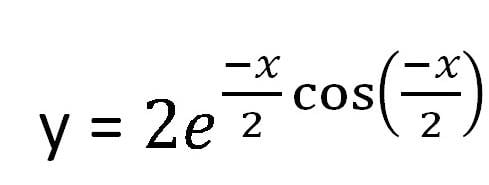

I am so happy that i found this site because it's been few days now that i haven't solved this function.
I hope somebody here can help me on finding the derivative of this function..Thank you so much.
If $y = e^{f(x)}$ then $y' = e^{f(x)} f'(x) $. Try that.

What Danny is using is the Chain Rule. The more general result of the chain rule is that if $ \displaystyle y = y \left( u(x) \right) $ (a function of a function), then $ \displaystyle \frac{dy}{dx} = \frac{du}{dx} \cdot \frac{dy}{du} $.
So in your case, you have $ \displaystyle y = 2e^{-\frac{x}{2}\cos{\left( -\frac{x}{2} \right)}} $, so let $ \displaystyle u = -\frac{x}{2}\cos{\left( - \frac{x}{2} \right)} $ so that $ \displaystyle y = 2e^u $. Can you now evaluate $ \displaystyle \frac{du}{dx} $ and $ \displaystyle \frac{dy}{du} $?

Correct! Now consider the case of $ \displaystyle e^{f(x)}$. The derivative is $ \displaystyle e^{f(x)}*f'(x)$. What is f(x) in this problem and what is the derivative of f(x)?
[sp]$ \displaystyle f(x)= -\frac{x}{2}\cos{\left( - \frac{x}{2} \right)} $[/sp]

One personal remark first: I don't like the idea that we should do your work ...
1. You must see at once that
$ f(x)=2 e^{-{\tfrac12}x \cdot \cos\left(-{\tfrac12}x \right)} $ is an exponential function.
What function do you get if you differentiate $ f(x)=e^x $ ?
2. You must see at once that your function is not a simple exponential function. The exponent is a function itself. Thus you have to use the chain rule when differentiating your function:
$ f(x) = e^{u(x)}~\implies~ f'(x) = e^{u(x)} \cdot u'(x) $
3. You must see at once that the exponent of your function is a product of functions. To differentiate a product of functions you have to use the product rule:
$ f(x) = g(x) \cdot h(x) ~ \implies~ f'(x) = h(x) \cdot g'(x) + g(x) \cdot h'(x) $
With your function you have:
$ g(x) = -{\frac12}x $ and
$ h(x) = \cos\left( -\frac12 x \right) $
4. You are supposed to know that
$ \sin'(x) = \cos(x) $ ...$ \cos'(x) = -\sin(x) $ ... $ -\sin'(x) = -\cos(x) $ ...$ -\cos'(x) = \sin(x) $ ...
That means during the differentiation of the exponent you have to differentiate the cos-function. BUT: the argument of the cos-function isn't a simple x therefore you must use the chain rule here:
$ f(x) = \cos(u(x))~\implies~f'(x) = -\sin(u(x)) \cdot u'(x) $
5. Now collect all the results to one brand-new function.
