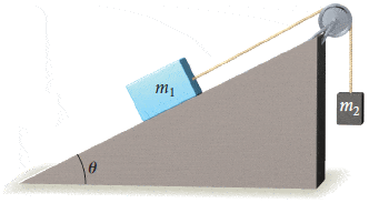

A block of mass m1 = 21.5 kg is at rest on a plane inclined at θ = 30.0° above the horizontal. The block is connected via a rope and massless pulley system to another block of mass m2 = 17.7 kg, as shown in the figure. The coefficients of static and kinetic friction between block 1 and the inclined plane are μs = 0.109 and μk = 0.086, respectively. If the blocks are released from rest, what is the displacement of block 2 in the vertical direction after 1.47 s? Use positive numbers for the upward direction and negative numbers for the downward direction.

You did not attach any figure.

Sorry, figure now attached
You forgot the coefficient of friction. And be careful, first check if the static friction is not too big to block motion. Decide if block 1 moves downhill or uphill. The force of friction acts opposite to the velocity.

You used the wrong sign when putting (m_2*a) to the right hand side of the equation. So the acceleration would be
a = [g(m_1*sin(30) - ukm_1*cos(30) - m_2)] / (m_1 + m_2)
As this is negative, your initial assumption about the motion of the system was wrong (you assumed that m1 moved down the slope, in the same direction the component of gravity pointed at.) So m1 will move up on the slope and m2 will move down. Rewrite your equations.

I'll rewrite the equations, but do I have to? As long as I know it moves in the negative direction (up the slope), won't that still give me the right answer?
New equations:
Fm1x = T- [µk(m1)g*cos(30)] - [(m1)g*sin(30)] = (m1)a
Fm2y = m2g - T = m2a --> T = (m2g) - (m2a)
(m2g) - (m2a)- [µk(m1)g*cos(30)] - [(m1)g*sin(30)] = (m1)a
(m2g) - [µk(m1)g*cos(30)] - [(m1)g*sin(30)] = (m1)a + (m2a)
g(m2-[µk(m1) cos(30)] - [(m1)sin(30)] = a(m1+ m2)
a= g(m2-[µk(m1) cos(30)] - [(m1)sin(30)]/ (m1+ m2)
a = 1.3386 m/s^2d = vi*t + 1/2at2
d = 0 + 1/2(1.3386)(2.1609)
d = 1.446m (mass 1 in the negative direction)

This is a one-dimensional problem basically. The motions happen along the rope, determined by the constrains (the surface of the slope and the constant length of the rope). The problem could be solved by splitting the motion of m1 into horizontal and vertical components, but the resultant should be along the slope and you would get the same equation as you used. It is not correct to
assign x to the forces acting on the slope, but it did not matter really.
