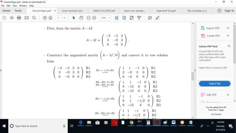

Now I have to find out the eigen vectors. It says:
Once the eigenvalues of a matrix (A) have been found, we can find the eigenvectors
by Gaussian Elimination.
• STEP 1: For each eigenvalue λ, we have
(A − λI)x = 0,
where x is the eigenvector associated with eigenvalue .
• STEP 2: Find x by Gaussian elimination. That is, convert the augmented matrix
(A − λI)X = 0
to row echelon form, and solve the resulting linear system by back substitution.
Right side is still zero. Do we have to convert into echelon form by using augmented matrix.
Zufi.
Hi Mark,
Case 1: _ = 4
We must find vectors x which satisfy (A − λI)x = 0.
Now they are using the augmented matrix (attached). Is there any way to avoid it
Zulfi.
Augmented matrices are not needed. Notice that after it says "Construct the augmented matrix ..." every augmented matrix has a fourth column of all zeroes. None of the row operations can possibly change this column, so what's the sense in keeping it? If you start with the un-augmented matrix in this section, doing the same row operations as shown in the screen shot will produce a 3 x 3 matrix that is the same as the first three columns in the last matrix they show.
The augmented matrix they show represents the matrix equation ##(A - 4I)\vec x = \vec 0##. Since the right side is the zero vector, you don't need to use an augmented matrix.
